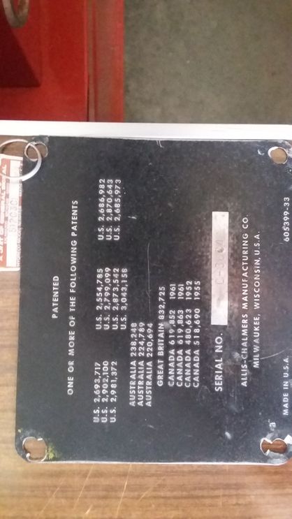

Post Options Post Options   Thanks (0) Thanks(0)   Quote Nephew Darrell Quote  Post ReplyReply Direct Link To This Post Posted: 01 Oct 2020 at 10:45pm
Welcome all the feedback and will attempt to upload pic of the data plate(not working for me so far).  I read the folllowing:
Allen Division
Stolrer Steel Products Corporation
Menonomel Falls, Wisconsin
Model D
SN 13326
Uncle also found another data plate with D5349 (no pic yet).  He’s confident this is a D Grader vs. the W or WD.  If so, what do you think the SN 13326 indicating?

Welcome to the forum!  The 13326 SN i for the Allen cab.  The machine SN is where DrAllis  says. The engine will have a W or WD before the SN, as the engines were built for tractors but used on many other units.

The 13326 might be for the cab?

The D5349 would make it a 1958, so you should have a WD45 engine in it.

1958 will be a D-17 engine if it has a horizontal rib on both sides of the block above the oil pan.
