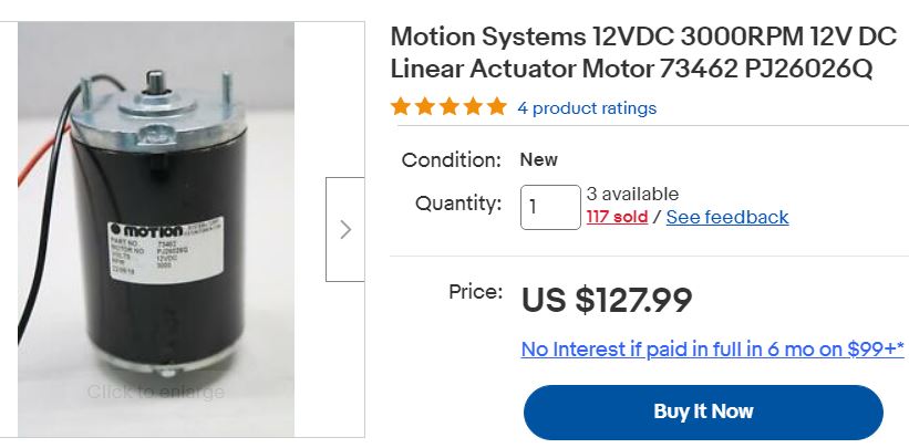

Mike , i did a GOOGLE search with your numbers and it gave a few "look here" at motors. Some were 12, 24, 48 and 90 volt .... I clicked on a couple of the 12 v motors to get an idea.. I think your going to have to get some additional data ..
The motor i show above turns 3000 rpm at 12 volts... Dont know if that is acceptable or not.. The end of the shaft looks like it has a GROOVE to fit over a coupling drive. Some have a gear on them.... Then you have to know about the two mounting bolts, spacing between them...
I dont think this is going to be a slam dunk.. I think your going to have to pull one of the motors off and do some checking..

PG12 means 12 volt... 58 means 58 :1 gear reduction...... you might call these guys and say " how much for just a motor"  and see what kind of response you get ??
