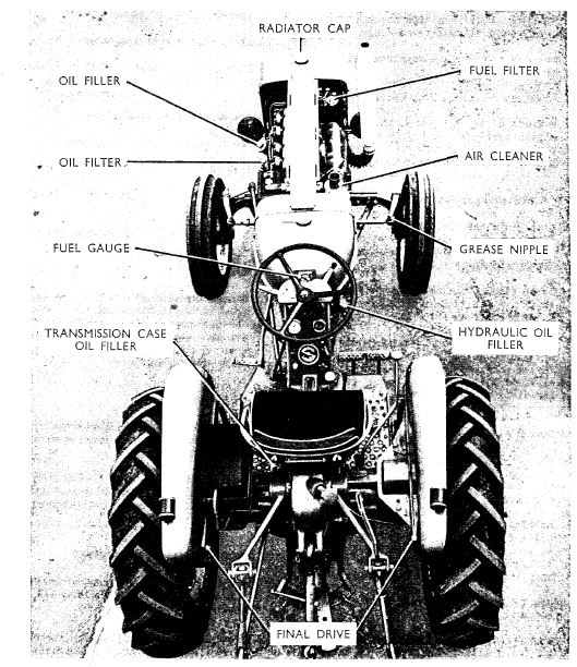

Anyone know where you check and add Hyd. oil owners manual shows a filler on the right side  just under  the back of tank but I don't see anywhere to check or add

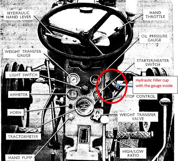

Post Options Post Options   Thanks (0) Thanks(0)   Quote John426 Quote  Post ReplyReply Direct Link To This Post Posted: 30 Apr 2021 at 4:10am
Have a look on the pictures attached.
Filler is in the right side panel under gas tank
