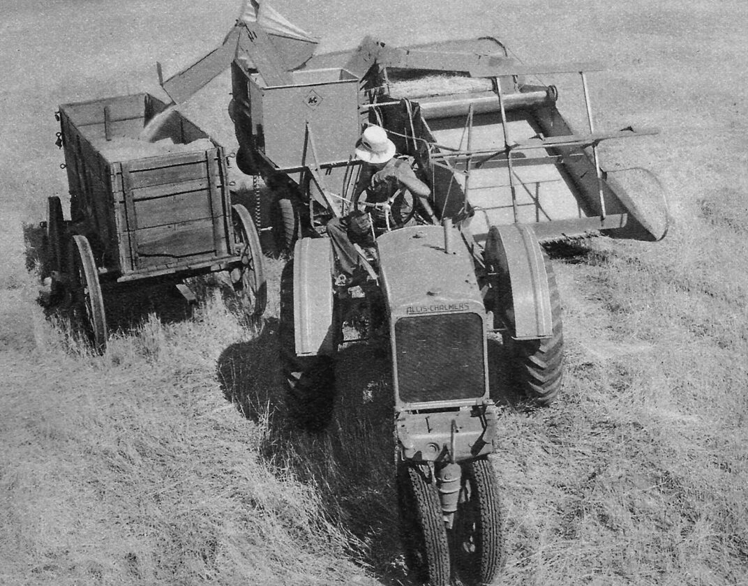

This the beastie?
Made in '38, '39, and '40, 15,000 or more of them...

This the beastie?
No sir, not a 40. This combine is one of the earlier ones that eventually became called the 60.
It's like what is shown at this timestamp here:

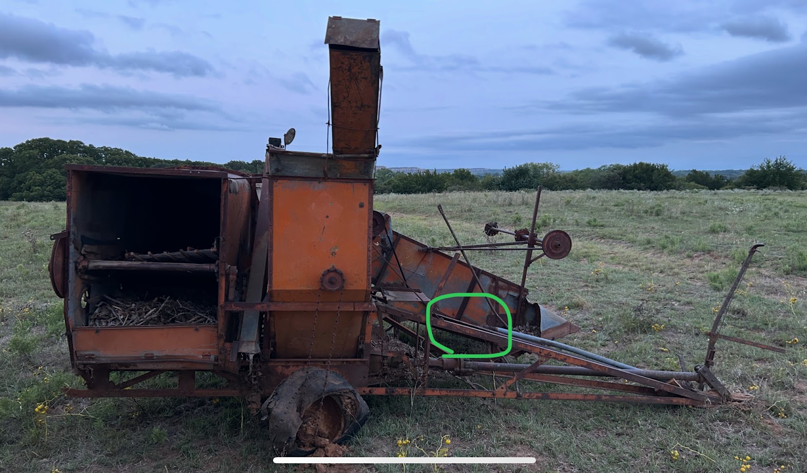

Mike, would you drag it home? I'm not big on having stuff around that I wouldn't use, but I may have to bend the rules on this one. Did drag an okay looking 63 plow home today.
Lon, I didn't take any good pics of it while I was there (sure wish I had now!) but I did find some neat ones on the internet. Here's one of them.

That is a camel back. very early and hard to find. Does it have the square tube above the cylinder like in the picture?

I don't think it did. From what I was able to find, that was something they did a recall on, or changed very early on in production?
Yes, the 1935 High Speed and the 1936 All-Crop Harvester had it, it’s a re-cleaning device for the tailings. The 1937 All-Crop did not have it, as they tended to shake apart. “Camelback” is a common term people use for the combines but it’s a slang rather than official title.

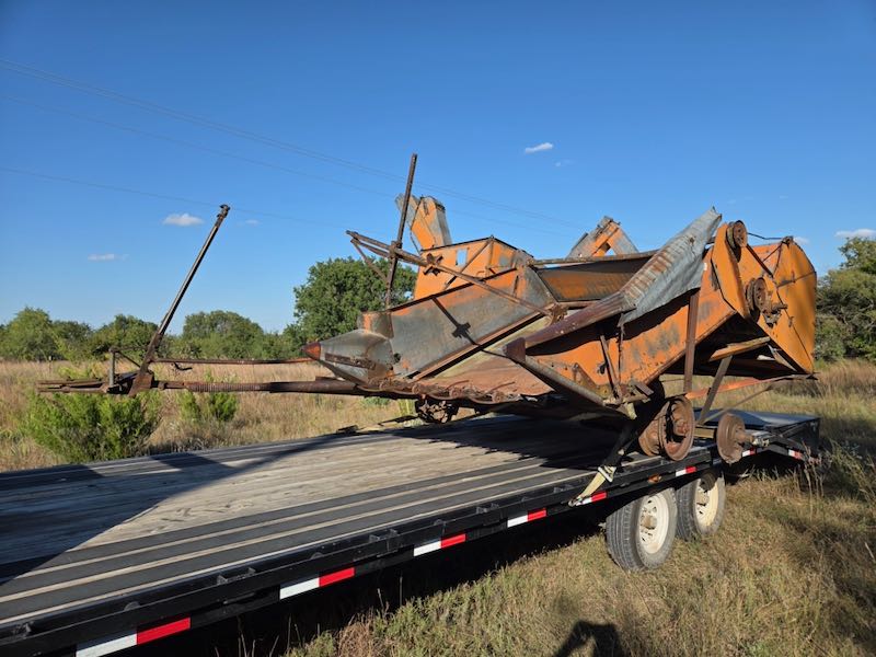

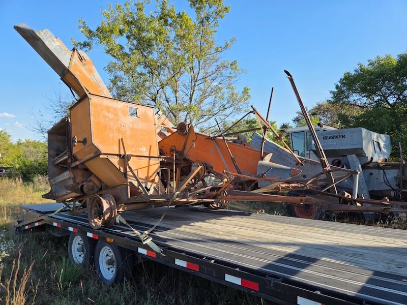

A good while later... I finally got it home today. It's rough and missing plenty of things, but I'm hoping with another one I could make a good early-ish combine. Wheels are good, header is pretty good, and the unloading elevator seems to be decent. Is that the serial number (11432)? It's stamped on the LH side of the combine near the cylinder, close to where it is on the newer 60s. The "7-" part is throwing me off.

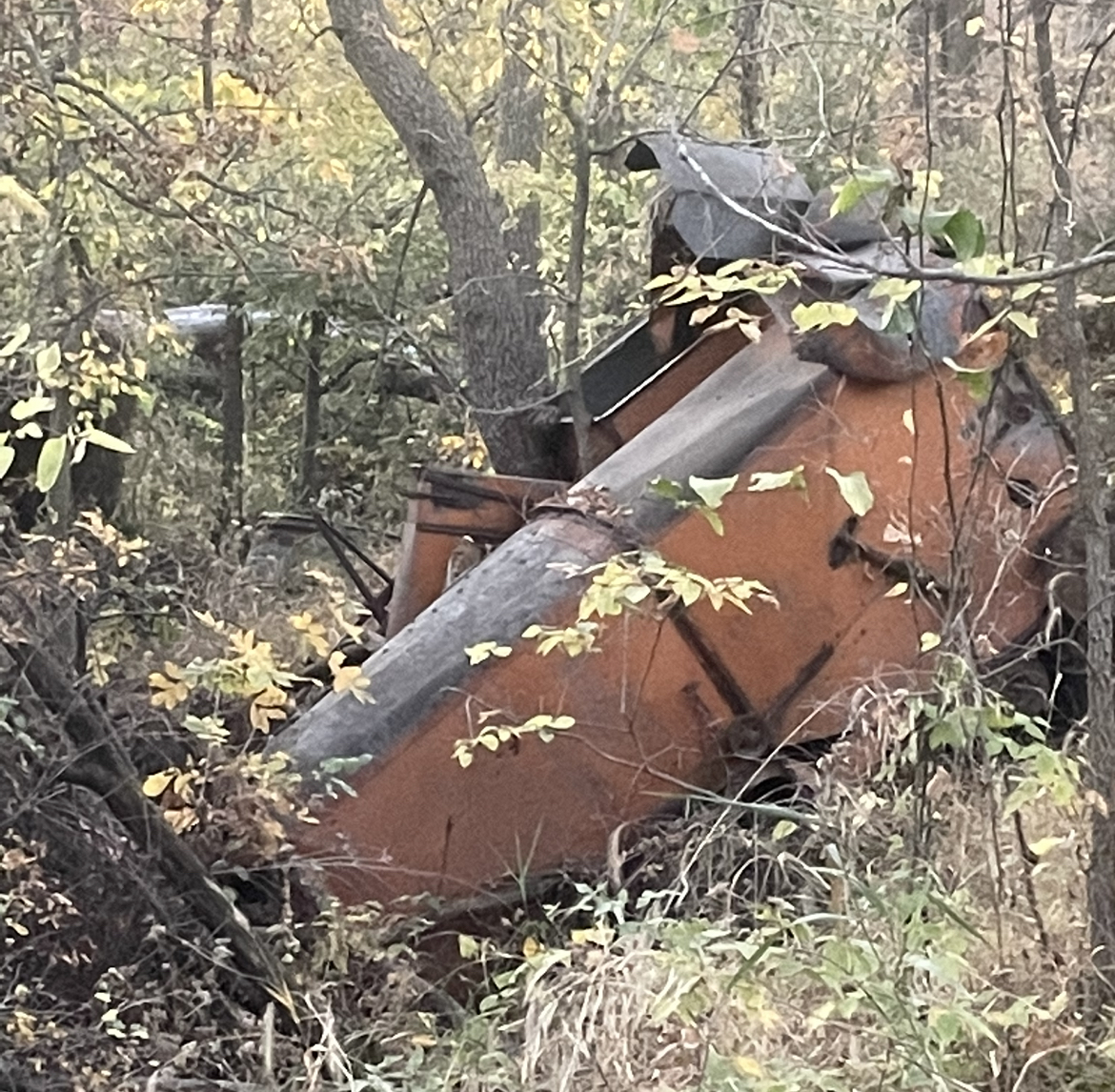

I might know of one in a creek near me…

I remember your post on those! Too bad they're not closer... those are exactly the sort of combines that combined (pun intended?) with mine might have enough decent parts to make a good one.

How “legal” was you when you hauled yours on the trailer?

No issues (disclaimer - everyone do your own research on your own state's rules for transporting ag equipment). I was under height but over 102" wide, so I only would've needed a permit if I had to go on the interstate here. I did not have to.

Ya know,, for as long as it's been settin,, it don't look THAT bad,, but the pictures don't really show the places where they really like to rust out.
Good luck with you new toy!!

The wood is rough and the cleaning shoe is actually entirely gone. The concave sheet metal is gone and some of the other low spots are rusted through as well. I need to take some better pictures tomorrow so it is clear how much of a heap it is. It also had a tree or something fall on the top part of the straw walker housing.
On the plus side I did get 1/12" (red/white clovers and turnips) and 3/8" (soybean) screens with it, which I didn't have yet.
Priority wise, this thing will probably sit until I find another. I'd rather get my newer 60 functioning first anyhow.

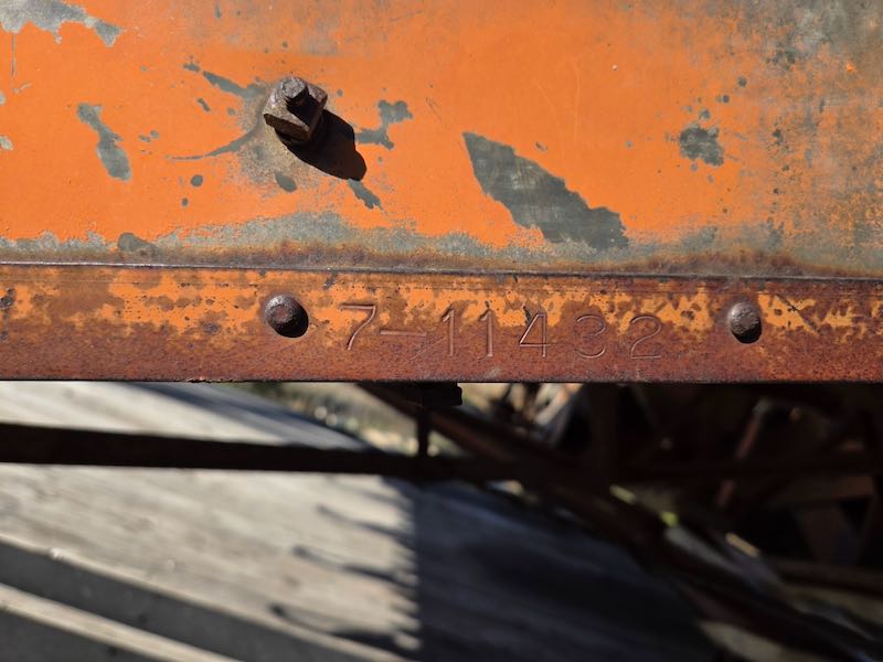

Unfortunately, it looks like your serial number is gone. It would be stamped on this angle iron piece in front of the bin. Looking at your machine, however, it's a 1937 model since it doesn't have the patched hole behind the cylinder where the original tailings recleaner  grain return would've been on the 1935-1936 machines.
The number you found by the cylinder, if that were a serial number, would place it as a mid-1936, which doesn't seem right, and the 7 in front throws me off as well. I'll check my machine again and see if it's got a number stamped in that location, but I don't recall seeing one there on the machines I've looked at.
