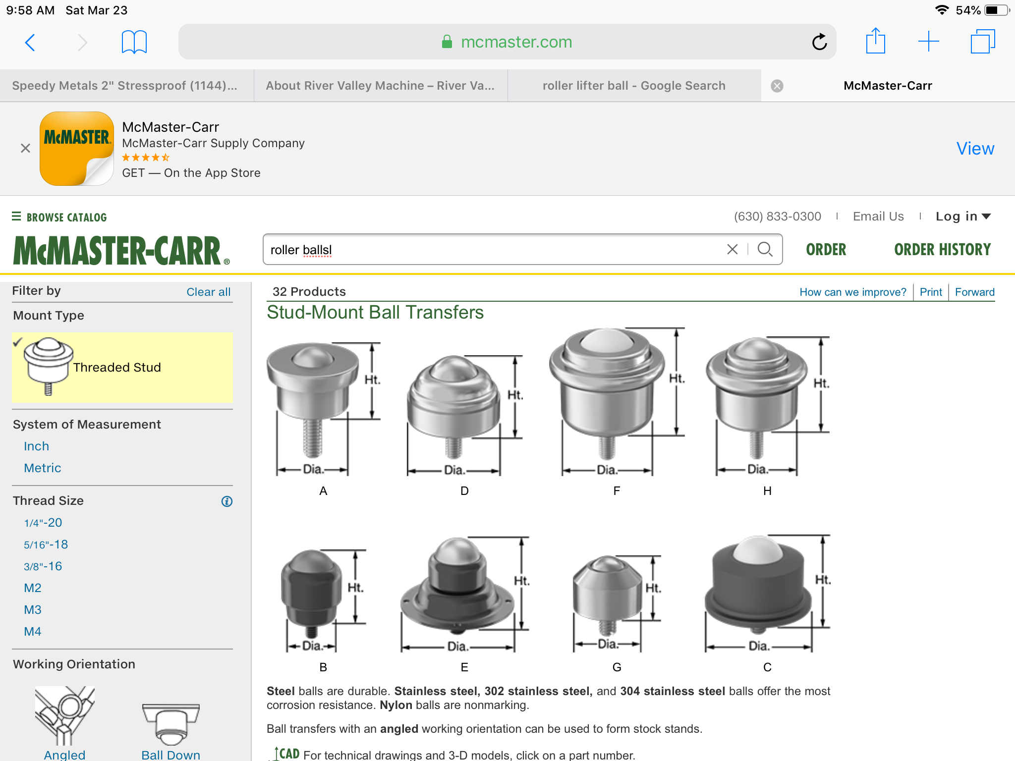

I was trying to engineer a roller bearing for bottom of pin.

May work with the roller bearing, although the design of the Allis seat/swivel relies on the lever dropping down into a slot so that lateral travel is fixed when  the seat is swiveled to the front or rear position.  The 715 is a pretty old but rugged machine, I think if you lube it well, (took me several applications of lube to stop screech) it will be smooth and silent.  Good luck with the project ~  Orangeman
