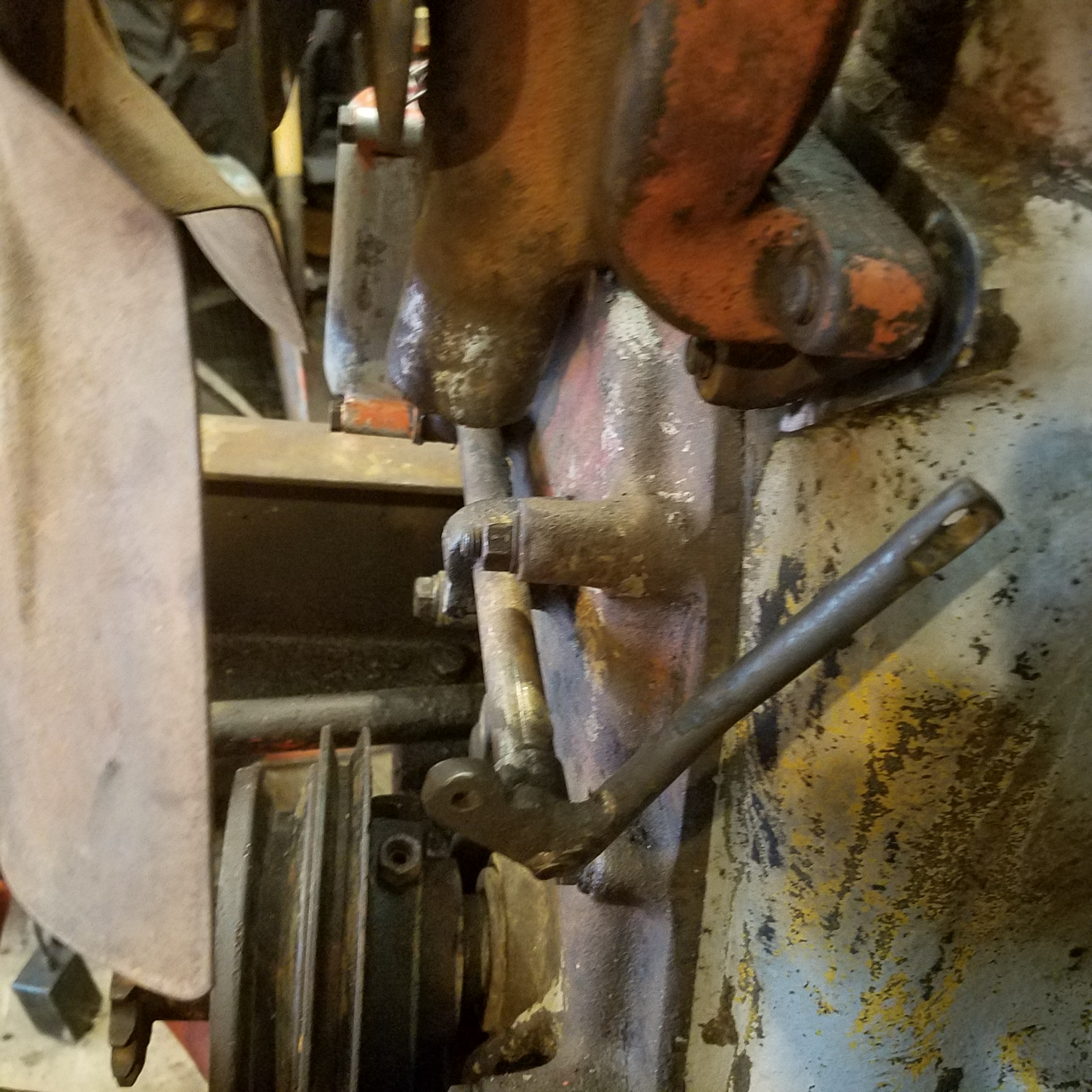

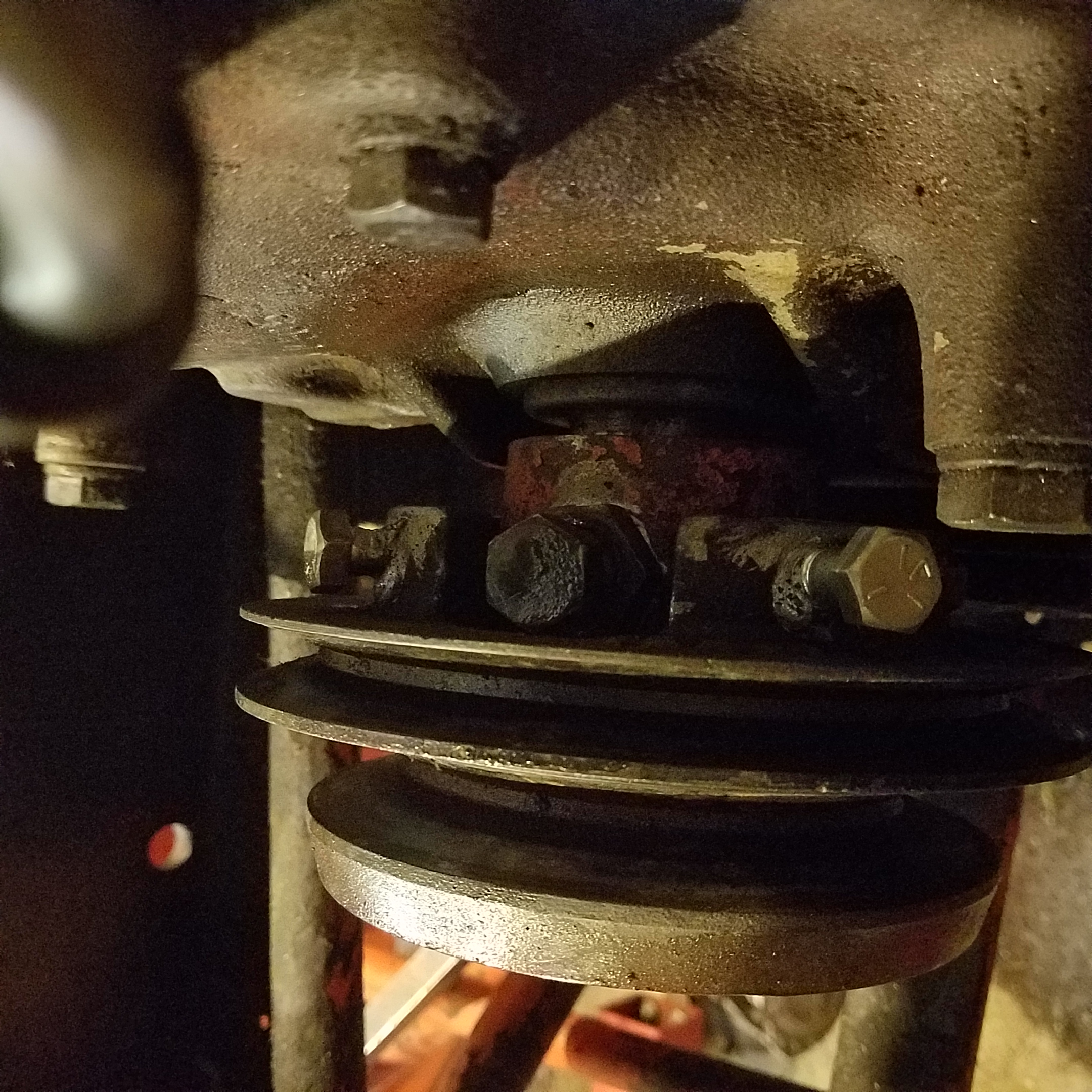

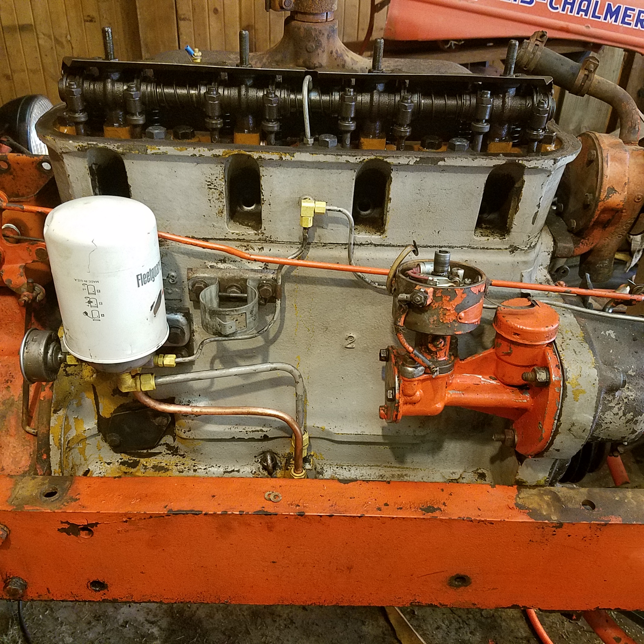

Getting my z block just about buttoned up. I cut the crankshaft down instead of bore out the pulley hub as Mack mentioned, it was faster for me to just cut it off. If I did it again I would machine out the pulley hub and leave the crank length. Push the pulley back closer to the seal and drilled a new set screw hole. Used the wd water pump, but had to remove a timing cover stud collar and used a shorter bolt to give the lower radiator hose clearance so it wasn't rubbing the hose. Here are some before and after pictures.

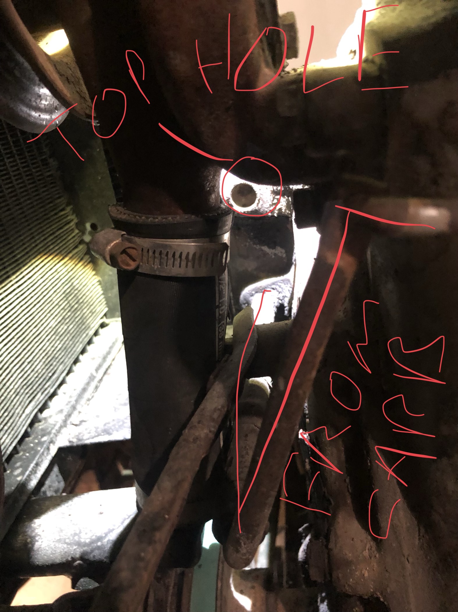

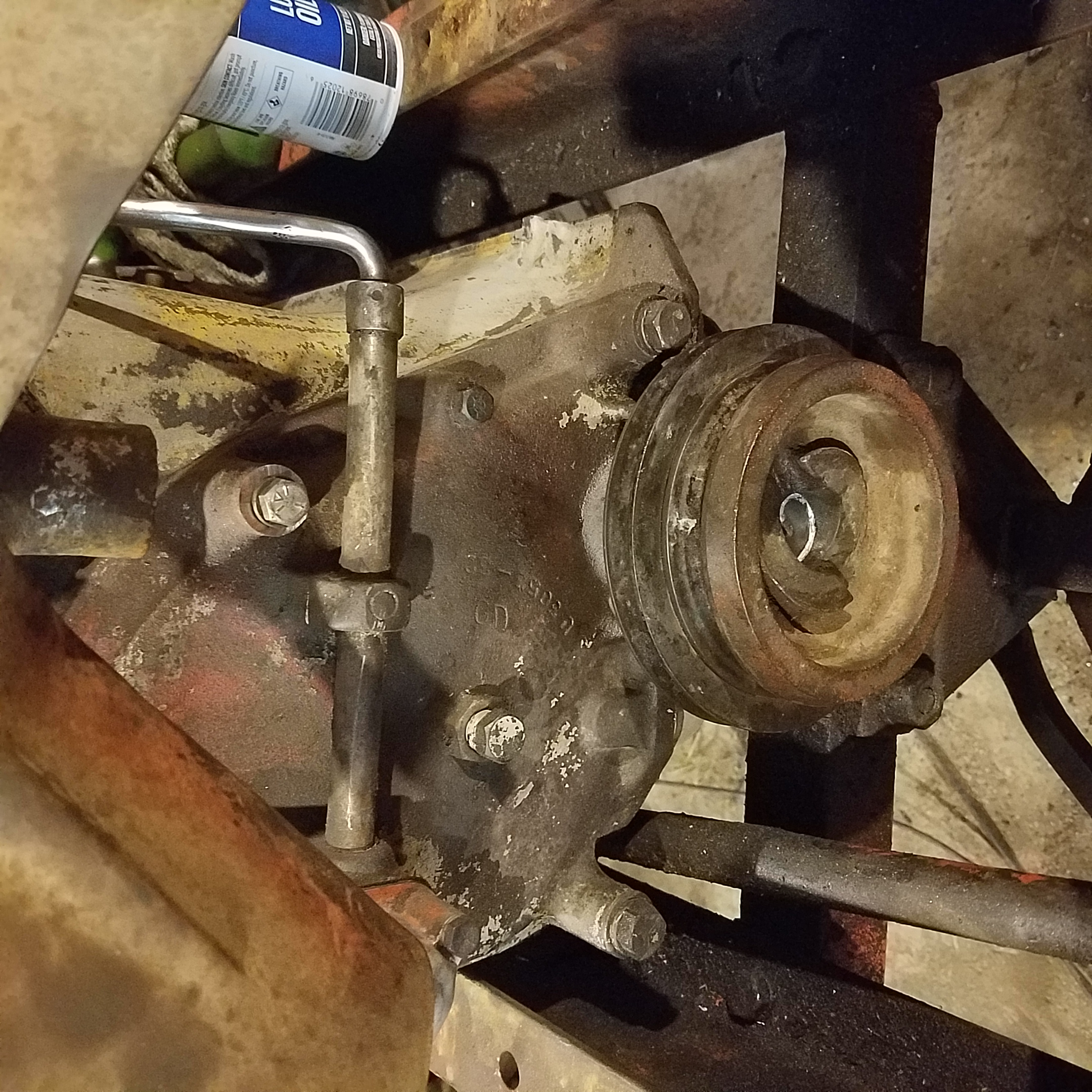

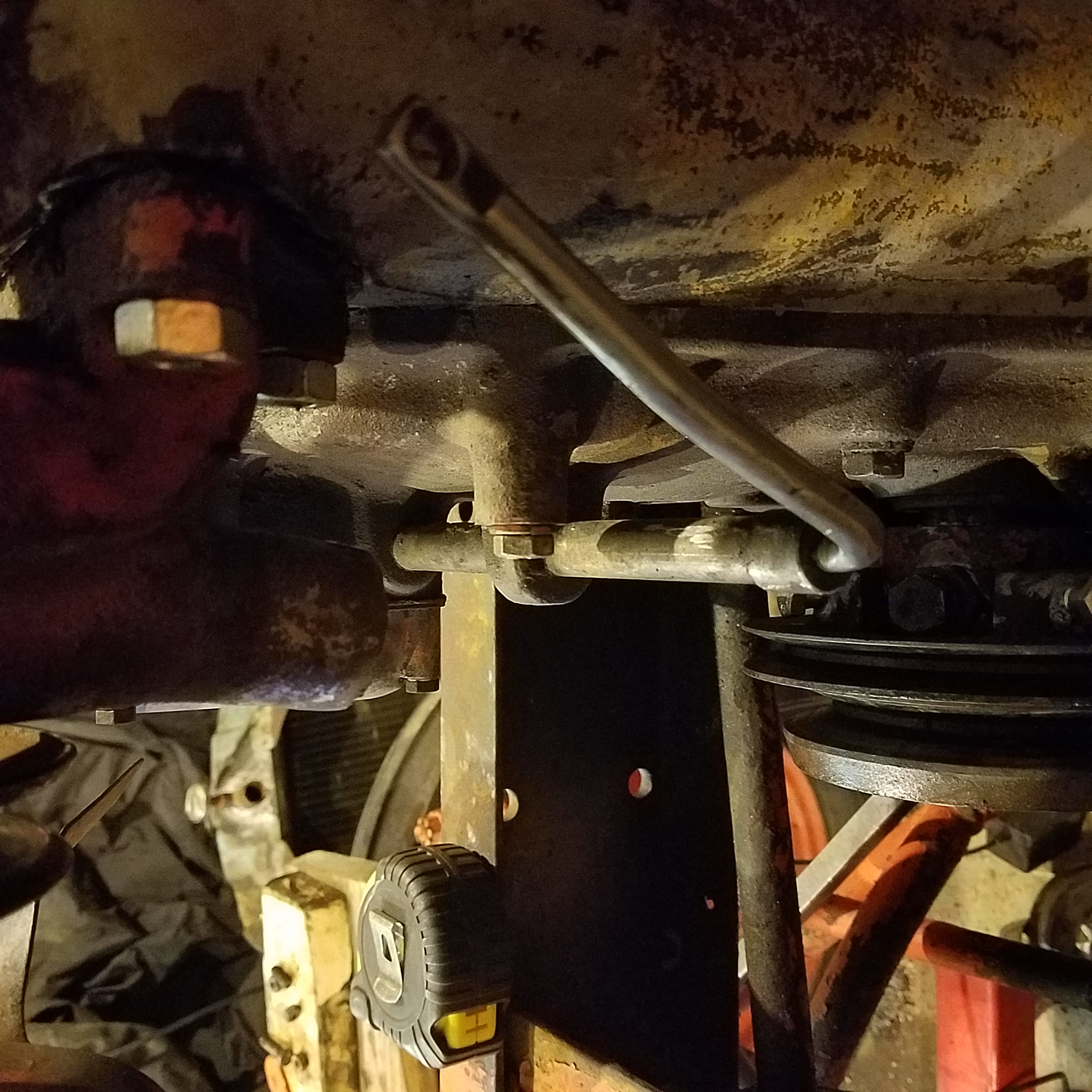

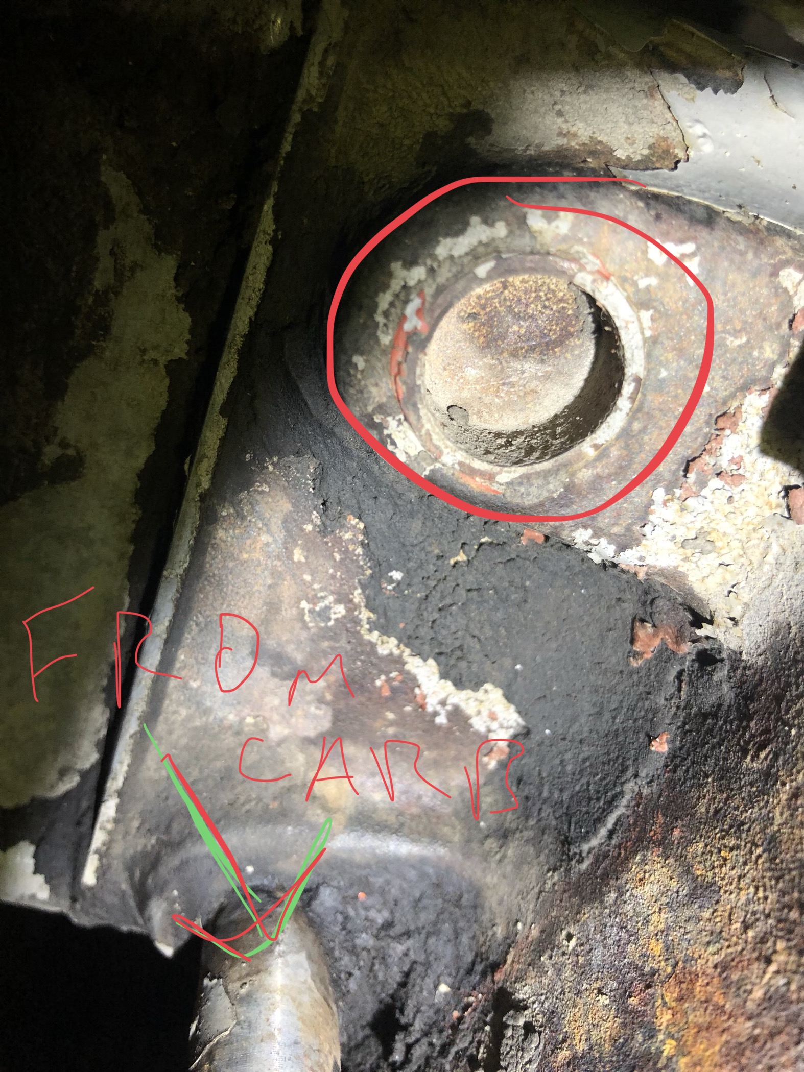

Do you have a picture of how the throttle linkage hooks into the governor? I just bought a Model D motor grader and it has the D17 out of Gleaner combine and they just have a janky universal throttle cable running from the carb to a plate they bolted in the cab. The correct linkage going from the carb around the fan side of the engine into the gov is there, but the linkage is missing going from the top hole in the gov to the original throttle control. The top hole of the gov appears to have a plug in it. Just wondering how yours it hooked up. I’ll post a couple pictures below.
