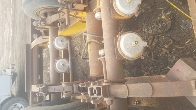

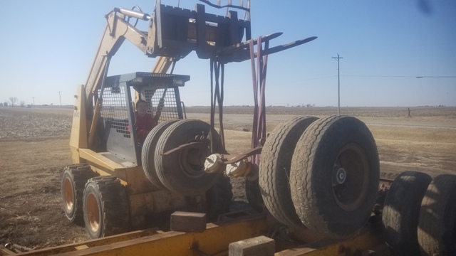

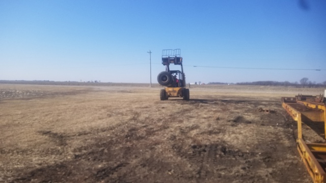

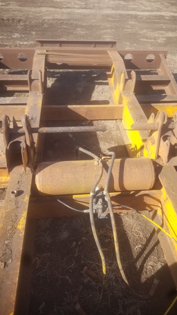

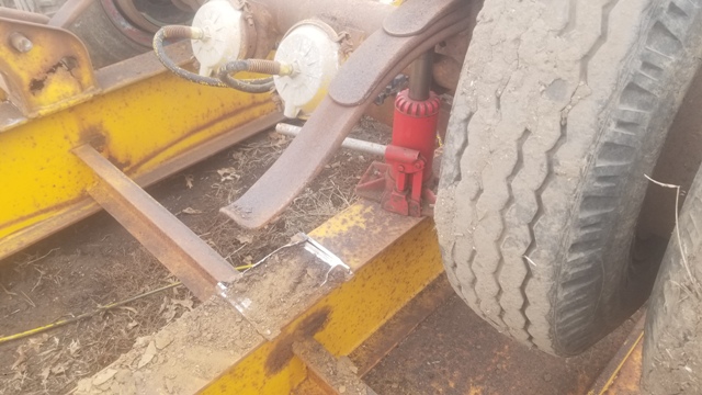

Got after the project pretty good this nice, warm day. Axels are ready to pick out tomorrow morning and I'll remove the rest of the suspension hangers after they are clear. Was only going to replace front hangers but discovered center hanger on one side perforated behind air tank so will replace both sides. Have the parts already so just a bit more time to complete the task.
First front hanger gouged off the frame:
After removing the bases of the front spring mounts:
Everything removed except axles themselves. I'll bridle and pick them out with the skid steer tomorrow morning. Then continue on with the task.
