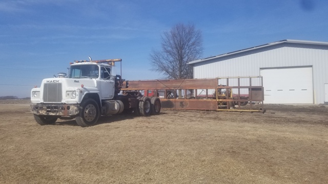

Little fun at the shop yesterday afternoon. Though I've replaced this trailer with an RGN unit, I've already purchased suspension hangers so will incorporate them with the improving weather. Last time I rolled this trailer over the weather turned sour on me by the time I could really get time to dedicate to the project.
I've always liked this trailer since building it in 1983 from two wrecked semi trailers' parts so may elect to keep it after all.

Shop property was the homestead for all the surrounding farm ground. I don't own any of the surrounding ground, only 2.2 acres the shop and house are located upon.
Snow finally melted off over the weekend so plenty muddy in spots.
Saw several Robins in the tree out back this morning so spring is coming!!

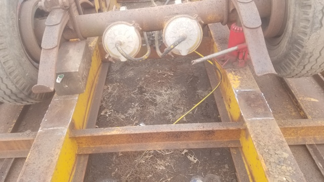

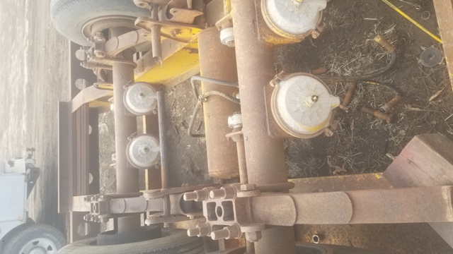

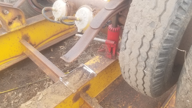

Got after the project pretty good this nice, warm day. Axels are ready to pick out tomorrow morning and I'll remove the rest of the suspension hangers after they are clear. Was only going to replace front hangers but discovered center hanger on one side perforated behind air tank so will replace both sides. Have the parts already so just a bit more time to complete the task.
First front hanger gouged off the frame:
After removing the bases of the front spring mounts:
Everything removed except axles themselves. I'll bridle and pick them out with the skid steer tomorrow morning. Then continue on with the task.
