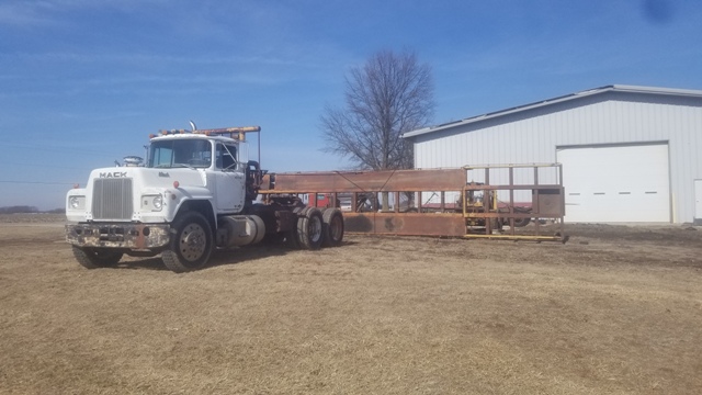

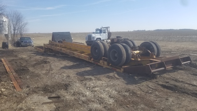

Little fun at the shop yesterday afternoon. Though I've replaced this trailer with an RGN unit, I've already purchased suspension hangers so will incorporate them with the improving weather. Last time I rolled this trailer over the weather turned sour on me by the time I could really get time to dedicate to the project.
I've always liked this trailer since building it in 1983 from two wrecked semi trailers' parts so may elect to keep it after all.
Something to do I suppose.

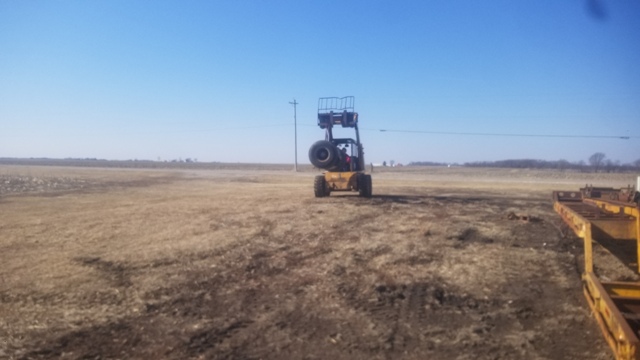

Shop property was the homestead for all the surrounding farm ground. I don't own any of the surrounding ground, only 2.2 acres the shop and house are located upon.
Snow finally melted off over the weekend so plenty muddy in spots.
Saw several Robins in the tree out back this morning so spring is coming!!

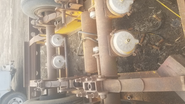

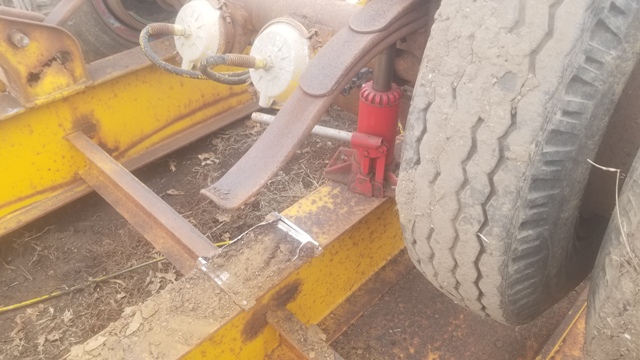

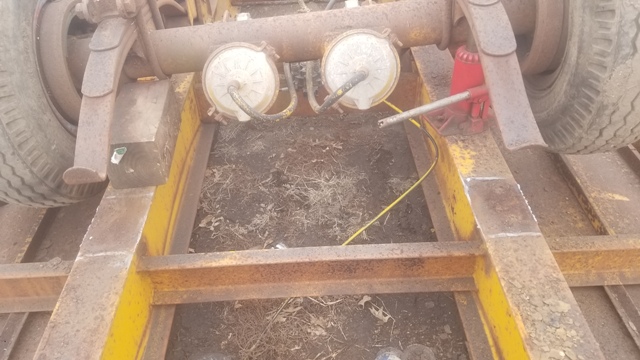

Got after the project pretty good this nice, warm day. Axels are ready to pick out tomorrow morning and I'll remove the rest of the suspension hangers after they are clear. Was only going to replace front hangers but discovered center hanger on one side perforated behind air tank so will replace both sides. Have the parts already so just a bit more time to complete the task.
First front hanger gouged off the frame:
After removing the bases of the front spring mounts:
Everything removed except axles themselves. I'll bridle and pick them out with the skid steer tomorrow morning. Then continue on with the task.

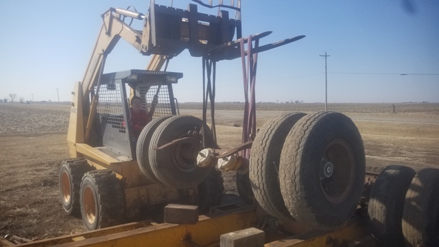

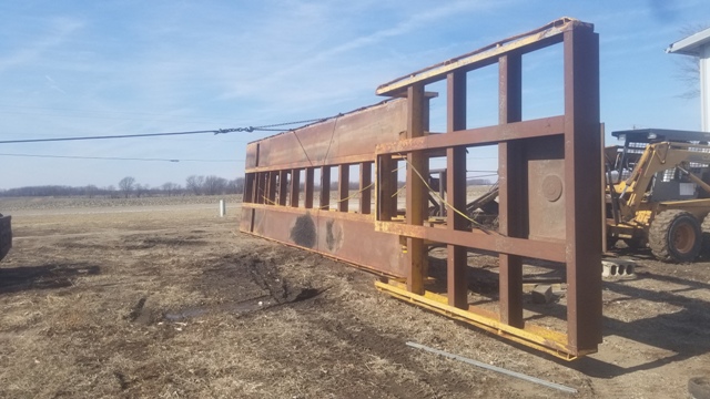

Being a firm believer in the power of "Slave Labor", I enlisted the help of my 14y.o. grand daughter to pick the axles clear and stage them while I drink coffee and watch:
Will be a bit easier to work with now.

Not many 14 year old's can do that! I frequently conscript my 15 year old Grandson for similar tasks.
Points: 90763
Post Options Post Options   Thanks (0) Thanks(0)   Quote steve(ill) Quote  Post ReplyReply Direct Link To This Post Posted: 13 Feb 2026 at 12:47pm
slave labor aint a bad job when you get to run a $10K Skid Steer !!!
Look like you got a GOOD HAND there for help !

She is actually pretty good in that loader. Her first lesson was when she was seven so has a few hours in the saddle. I routinely let her drive the car a 21 mile stretch from a Pekin, IL to Farmington where my shop is located. It is mostly country roads, but not all; no city traffic. She does well. Did the same with my kids when growing up.
Also have had her blasting, (at low pressure) and she should be able to help with this trailer as it nears completion. Still a bit light in stature to be withstanding the "push" a blast hose imparts.
What is neat is she really likes working with me for some reason?????
