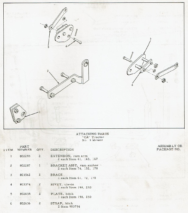

Post Options Post Options   Thanks (0) Thanks(0)   Quote PaulB Quote  Post ReplyReply Direct Link To This Post Posted: 18 Jan 2026 at 1:27pm
here's the page from the parts book. Nothing is shown as different from the PinHitch to the SnapCoupler tractors. However from what I see here and knowing the differences the rivet (#4) should go through the furthest hole for the rockshaft which you will not have on a snapCoupler tractor.
  The CA PickUpPlow manual shows how to change positions of the rockshaft for lift or drawbar work. You will need to have the rockshaft in the position for drawbar work and remove the lift latches. Using the remaining hole on the rockshaft after removing the lift latches will most likely have the front of the mower too high and a PinHitch rockshaft is probably needed unless you fabricate a workaround.

Post Options Post Options   Thanks (0) Thanks(0)   Quote Trinity45 Quote  Post ReplyReply Direct Link To This Post Posted: 18 Jan 2026 at 6:55pm

Post Options Post Options   Thanks (0) Thanks(0)   Quote PaulB Quote  Post ReplyReply Direct Link To This Post Posted: 19 Jan 2026 at 7:22am
Remove both cylinder pins from the rockshaft, let rockshaft lower all the way to vertical and re-pin lift cylinders in to other hole, as shown in many implement manuals.
