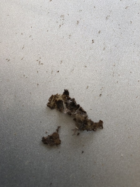

   I couldn't fine my other thread,,, so here goes,,,,,,, I was piddlin on the Massey Ferguson engine getting some measurements to machine a "sleeve pulling thingie when I noticed something odd on #4 rod journal on the crankshaft. I had went ahead and pulled the crankshaft to get better access to the #4 sleeve. I look closer and,,,,and,,,the friggin oil hole in the shaft looked to be plugged up,,,I tried to poke the stuff out and it was packed in tight,,,!!! I made me a little cotkscrew and fished out a lot of what looked like perforated pieces of plastic,,I mean all the way thru the oil journal to where it comes out at the rear camshaft bearing register,,,,,WTF,,,??? I'm told this model of Continental engine uses an oil filter inside the oil pan and this looks to be the same material as those filters, I went ahead and pulled the camshaft and blew out ALL the oil galleys,,(this was the only'ist one that was plugged) and then blew everything out again for good measure,,,,,
 There,,,,I feel much better now,,,,,,,ClapClap
 waiting on some phone calls bout some parts needed and I be ready to start assemblin
 See what ya'll think it looks like,,,,,

Looks like trouble!

This reminds me of when I found a piece of felt crammed in the back of the crank shaft on my B. Lol
Going by the pics I don’t think the stuff in Joe’s crankshaft is supposed to be there.
