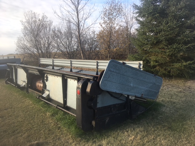

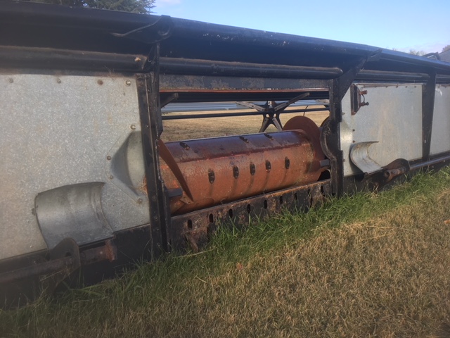

The header is about 3+ hours away so I asked for some pics. This was before I read your post Gm Guy. I could phone again to verify that it is a straight M. But we're supposed to get snow...and might not combine at all if the weather doesn't improve. So the swather is going out!
I've noticed it has mechanical drive for the reel.   And my L3 has variable hydraulic drive.   I'm guessing this is a straight M?

Post Options Post Options   Thanks (0) Thanks(0)   Quote GM Guy Quote  Post ReplyReply Direct Link To This Post Posted: 05 Oct 2018 at 1:27am
Definitely off an M with the Flighting extensions and the stripper plate extensions.
Cannot tell if its straight m or L/M without seeing SN plate.
Drivelines are correct.
Not a 2 or 3 series, definitely a first generation, so the upright will need trimmed. way less trimming on a L2/3 application than M2/3.
Overall looks like a decent enough head.
If you have a grain spec machine, you may be missing the variable speed valve in the stack that was used for this style reel, as well as the variable speed feederhouse on the corn/soybean spec machines. I have a L3 this way.
