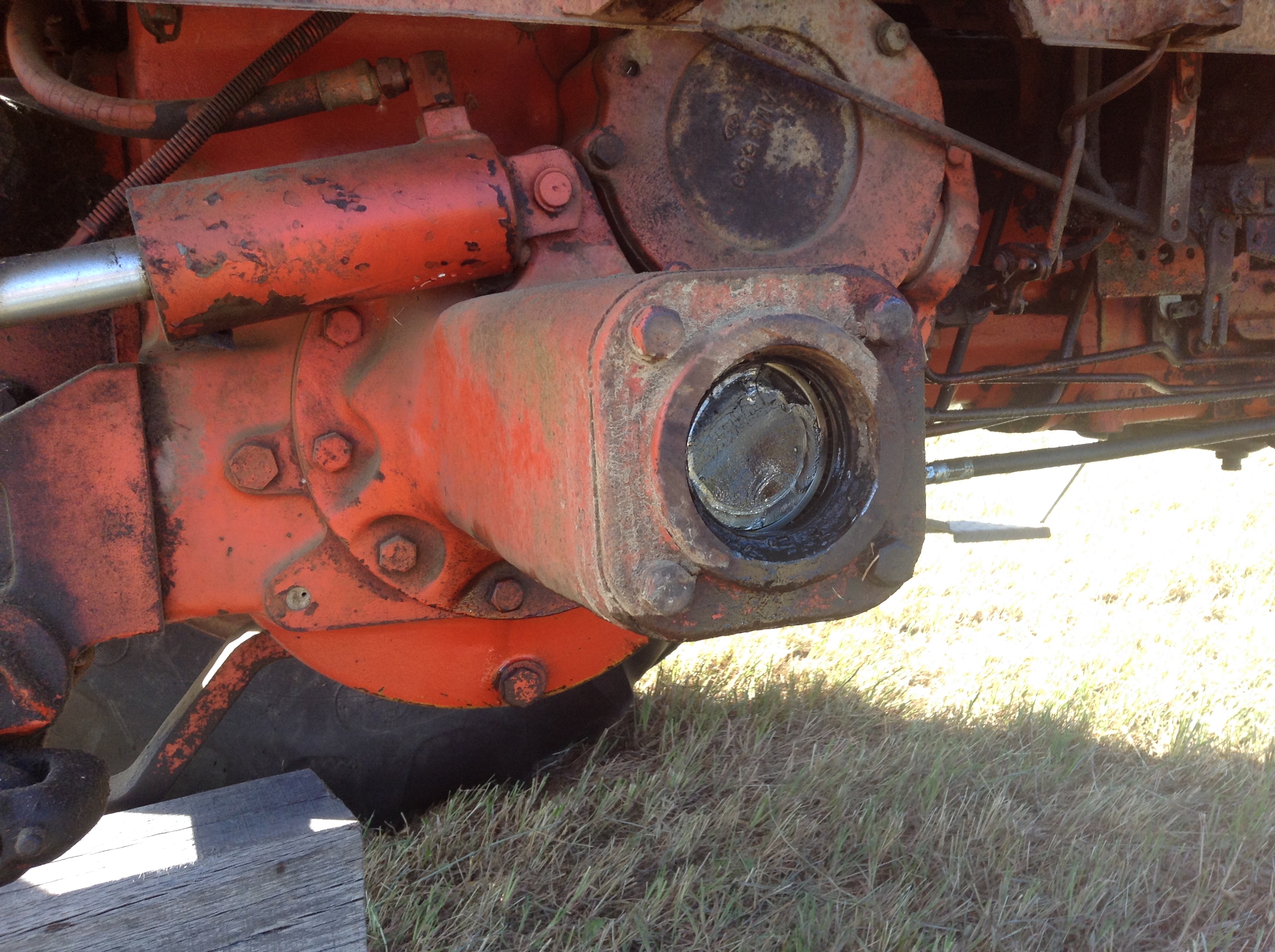

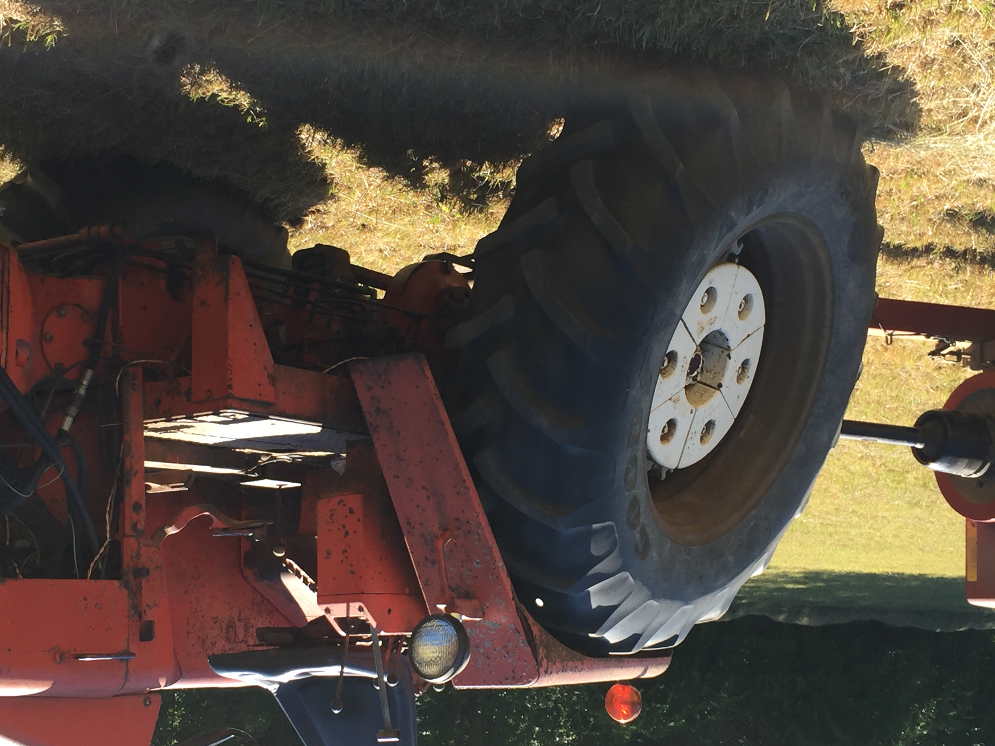

So I picked up this 190D at auction in March, she is a 1965. Did fluids, filters, lights and front tires and rims. Pretty happy with it, paid $2250 and put another $750 into it. Put about 100 hours on it, doesn't jump out of any gears, life is good. baled the last of my 54 acres of hay yesterday and on the next to the last trip around the field pulling the square baler and a flat wagon I heard a pop and she leaned to the left a little. So, need to build a shoe and bolt it on somehow to get it across the field and down a 1/4 mile path through the woods then on a ramp truck to get it home. The axle replacement in the manual seems straight forward. This is I assume the soft axles, are there anything different in the hardened vs soft axle parts, or just swap axles? Since one broke, I would like to swap both to hardened. Are there any out there? from my untrained eye it appears it broke inside the bearing and has been cracked for a while. any words of wisdom, or should she be parted out?

Not much to say except go to a salvage company and find another one. It looks as thought it didn't break instantly.

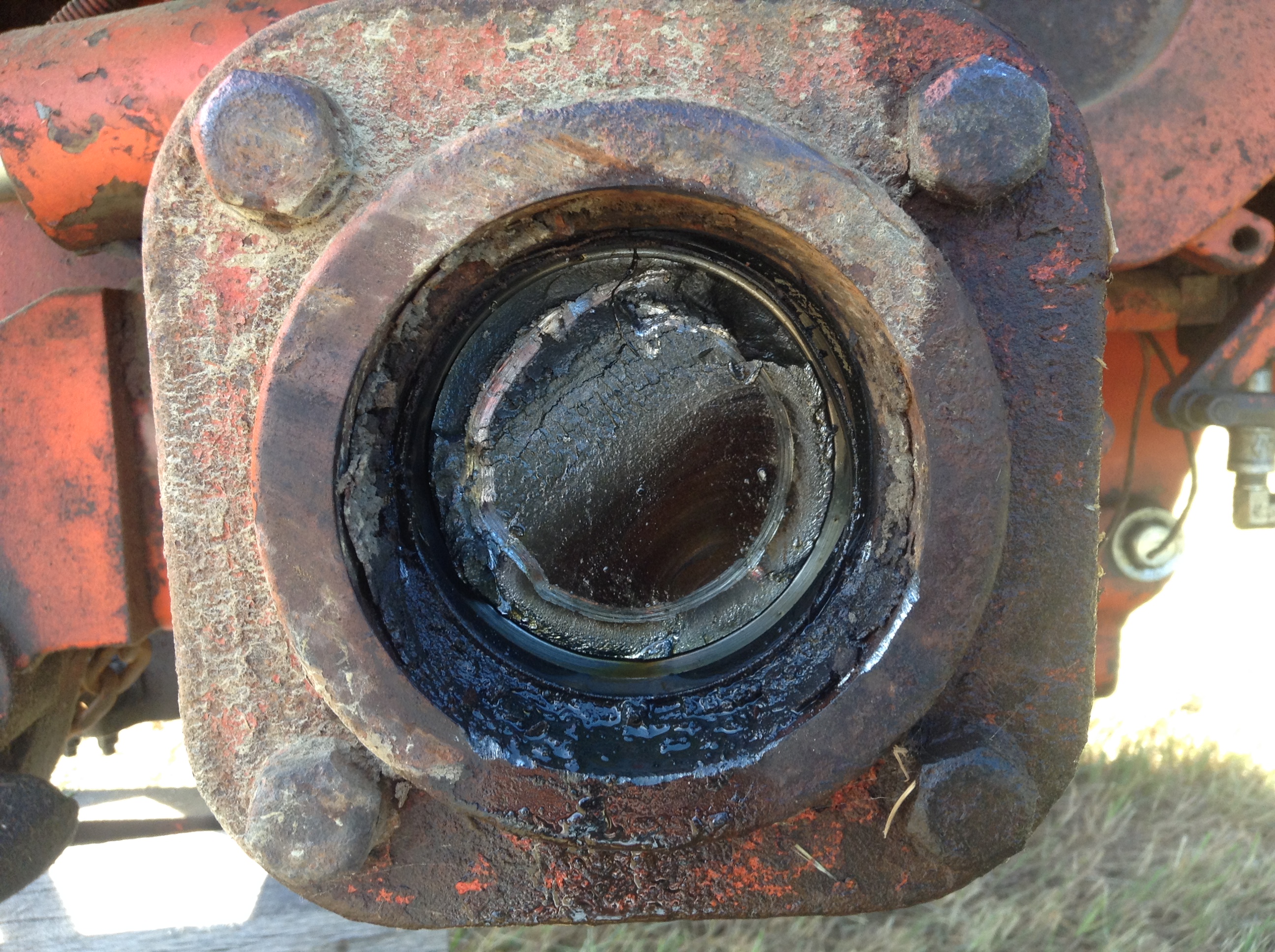

Maybe it's just me, but thought I'd share. When I zoom in on the photo of the close-up of broken axle, it looks to me like its outer circumference has been welded??

thanks for resizing. who the heck would weld an axle! could be any type of old repair, came from an auction, history unknown

looks welded to me.....
Post Options Post Options   Thanks (0) Thanks(0)   Quote CTuckerNWIL Quote  Post ReplyReply Direct Link To This Post Posted: 05 Jul 2016 at 11:15am
It looks to me like it was cracked more than half way around for a long time. It also looks like it might be case hardened ?

Looks like the seal is gone, bearing got hot, cracked axle...

I don't think tying the steering wheel on a tractor with hydrostatic power steering will work. I really really really doubt that axle has been welded either. I don't think it would have made 100 hours if it had but who knows. Can you get the ramp truck to the tractor? Life would be a whole lot easier if you could. Good luck.

I don't think it's been welded, looks like a typical 4000 series steel axle that failed to me, harder on the outside with a tough core, once again common with oil quenched 4000 series steel.

You don't hear of them failing very often. It may have been abused at one point, you'd never know. Just find a replacement at a tractor salvage place. While you're at it, inspect the other axle.

every shaft I have seen brake looks like "it has been broke for a while"
per parts books all below 9000 sn 1966- has small axles,  it either has to have large axle rear end swap or replace with small axle.  Larger axle will have to have wheel center chocks as well, if replaced. I would find a small axle.  Rare to break under non tillage conditions as in 5 bottom pick up plows or chisel plows.. etc...
