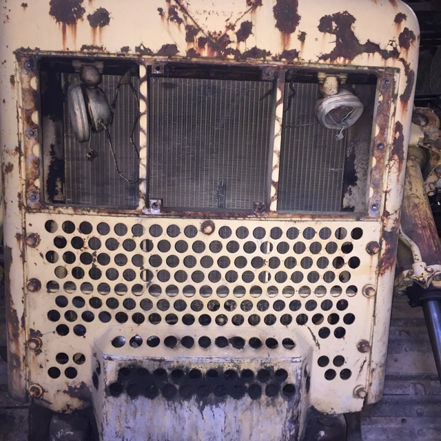

While going through my HD16 which I have had for 2 weeks, found the following:
1.Final drives very low on fluid in both sides. Can see fluid but way below the plug.
2. Hydraulic fluid low. Again you can see it on the dip stick bit just.
3. Generator not charging batteries. Found belts loose enough to almost take off pulls. Bracket froze but PB Blaster over 4 days and a 4x4 helped get bracket released and belts tightened. :)
4. Air filter trashed. Has the Donaldson dry filter. Took 3 hours to get it all apart. Filter packed.
5. Battery cables cracked and several breaks. Just picked up 30' of 1awg welding cable and will replace all cable and connections with soldered terminals and a pair of new batteries.
6. Cool surprise on the front end. The top front grill was taken off to check radiator and oil cooler. Found a pair of stock headlights hiding behind the covered up headlight openings. Complete pair with wiring and brackets. The headlight buckets are busted up and the bulbs missing but pleased brackets and all wiring is there.
7. Not doing much with the froze track adjusters but got them to take grease and am going to let them sit awhile and put pressure on them a little at s time each day to see if they will must loose and NOT BLOW THE SEALS INNTHE PROCESS.
Took hammer and chisels to old grease, dirt and what ever else has turned to stone around all areas of the tracks and idler arms and yokes.
Loving every minute of it!!!

Per item #6, what I found when I took off the top front grill cover. LIGHTS!!
