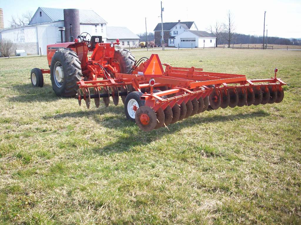

we pull this one, I think its 12' or so with a 185. does a great job...Jb

jb, is that a 2300 disk?
Yes it is a 2300 dad bought 30 some years ago. we recently went through it and repainted it, and had new decals made etc. we bought a middle buster from a forum member and its a totally different machine now,,,Jb

I thought it was, but wasn't sure. It is a very nice looking disk!!
