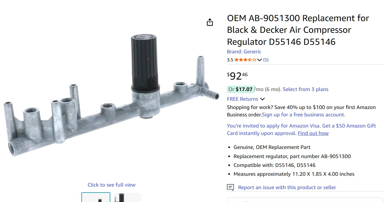

  Howdy,,,I have a Dewalt D55146 portable roll around air compressor that am having issues locating repair parts for.
 It is leaking air at the regulator and both Amazon and Ebay do not list the regulator by itself but do sell the regulator WITH the manifold for $200 +-
 This regulator started leaking last year and the only part available then was a "REPAIR KIT" which I installed,,but now that DANG thing is leaking again. You can order a manifold from amazon or ebay with the regulator but no gauges etc but also very pricey,,,,,

something like this ???
Points: 90826
Post Options Post Options   Thanks (0) Thanks(0)   Quote steve(ill) Quote  Post ReplyReply Direct Link To This Post Posted: 21 Sep 2025 at 10:37pm
dont see the reg by itself.... you can get the ENTIRE package with gauges and reg for $200 as you said... this appears to be the CHEAP option.... unless you buy a generic regulator and some pipe fittings and screw everything together... Probably still have $90. in that..

 Hey Steve,,I was hoping to buy an OEM, shore enough Dewalt regulator as I already bought one of these "generic" rebuild kits for that regulator a year or so ago. The Factory (OEM)  Dewalt regulator was NOT available then either,,,,? The main item description heading on this one says OEM,,,then right below that,,it says Brand is GENERIC,,,,??
 The "Complete"one you also refer to at $200 is also "generic"
 Being some what,,,"Thrifty",, I am now considering looking for a popular brand name regulator with it's base fitting and make my own manifold  as there seems to be lots of traffic for the Dewalt replacements,,,prolly for good reason,,,errrr,,,bad performance,,,!!

If that part pictured is a manifold - then I would make up my own from pipe fittings .
Standard Sch 40 water pipe is rated at 125 PSI so if you set pressure switch to that or less it would be OK or go to next step and get Sch 80 pipe and fittings with a 220 PSI or greater .
  I would make a manifold with a couple ports and install quick disconnect fitting into it so regulator could be plugged into it when needed , not in use at all times .
