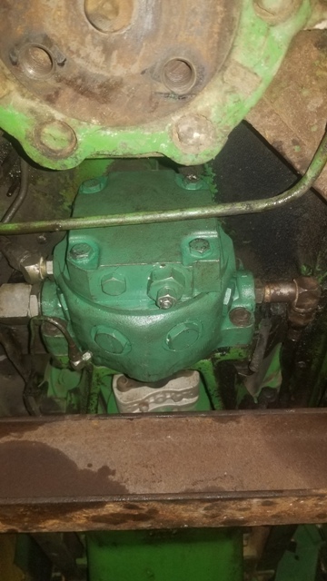

3020 Deere. Really good condition but main hydraulic pump has taken to seeping. Works fine but is needing resealed. Owner purchased a brand new one as doesn't want to have problems later on as tractor is a working unit. Multi year loyal customer so I won't tell the family "No" to any work they need. Pays well too in cash at job completion:
Parking spot in the shop:
Steer axle removed for clearance:
Leaker:
Damned pump is heavy so used transmission jack to remove it from the tractor:

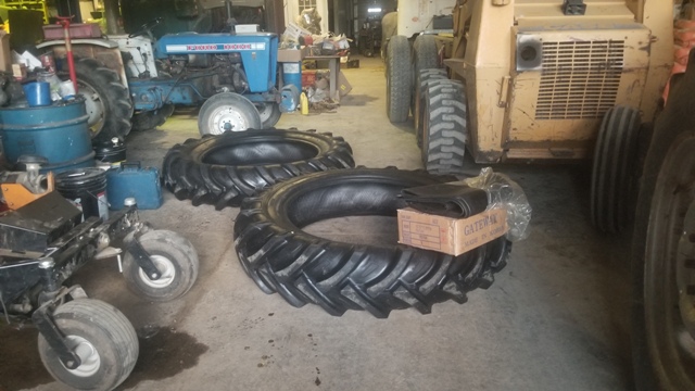

Owner ordered brand new rear tires and tubes and they will arrive at the shop this afternoon. Old dry rotted and cracked originals are full of calcium so I'll need to see if that gets replaced or not. I'll blast the rims clean and paint them up before remounting the new tires.
This job will partially fund other projects going on around the "hood".

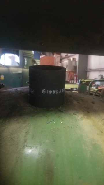

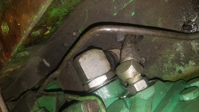

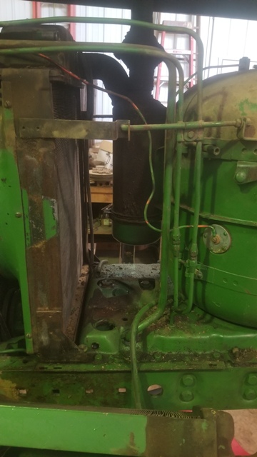

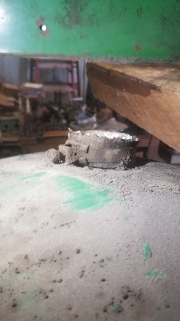

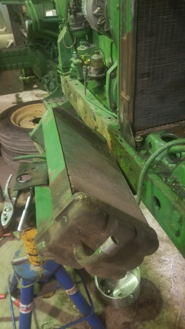

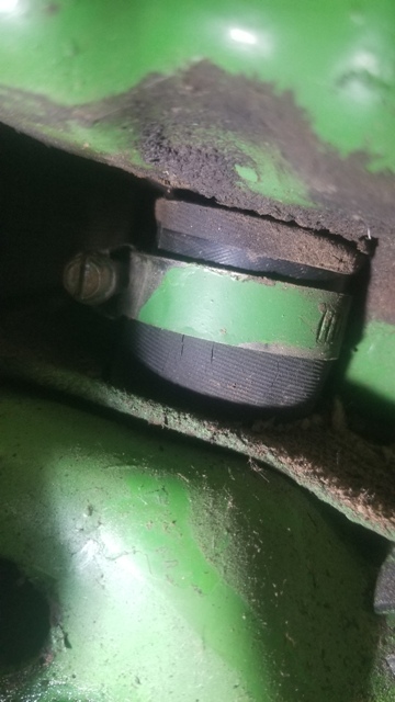

Pump installed:
New cruising tires:

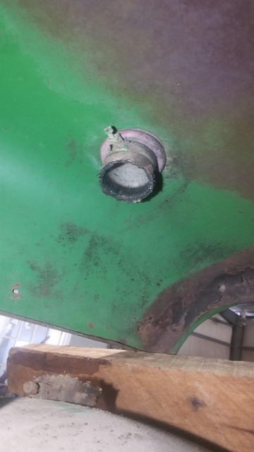

Fuel filler hose on bottom of hood panel:
Other end of hose on fuel tank:

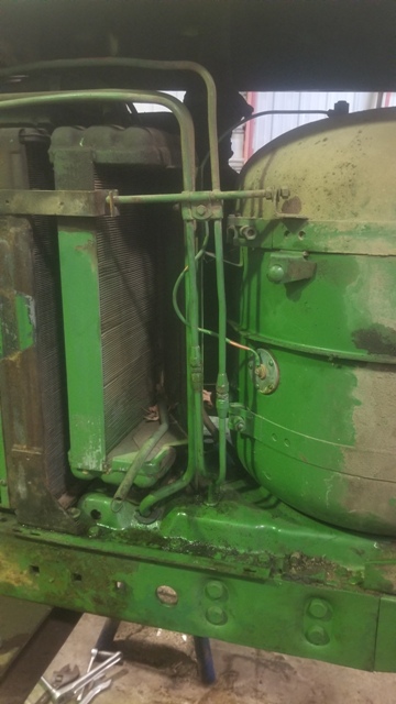

Oil cooler outlet, hydraulic pump inlet coupling hose:
Oil cooler before removal:
Oil cooler removed:
New section of fuel filler hose. I'm awaiting the oil cooler discharge hose into the pump and should have Thursday. Strange size and I don't do "Fitz All" repairs if correct parts are available:
