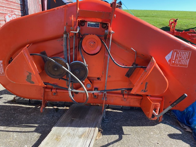

Points: 8924
Post Options Post Options   Thanks (0) Thanks(0)   Quote Mikez Quote  Post ReplyReply Direct Link To This Post Posted: 26 Apr 2024 at 7:05am
Your 818 decks main attachment is from front. Looks like that other deck is to the rear. Send me some pictures of 818 deck and I’ll see if I can tell what’s missing.

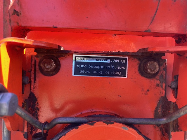

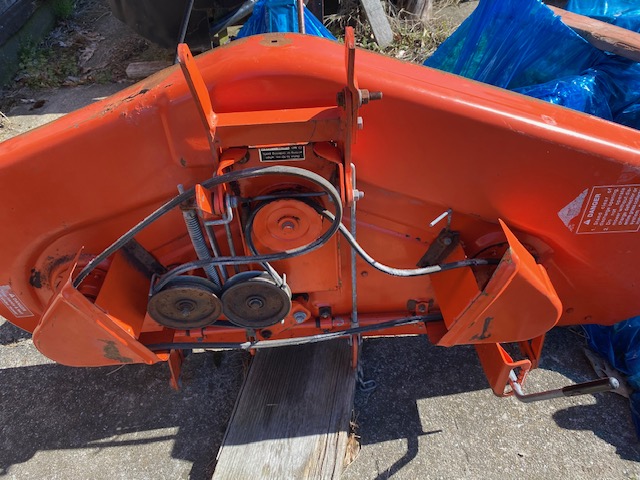

Post Options Post Options   Thanks (0) Thanks(0)   Quote captaindana Quote  Post ReplyReply Direct Link To This Post Posted: 26 Apr 2024 at 1:18pm

Post Options Post Options   Thanks (0) Thanks(0)   Quote im4racin Quote  Post ReplyReply Direct Link To This Post Posted: 26 Apr 2024 at 6:22pm
I really don’t see anything missing

Post Options Post Options   Thanks (0) Thanks(0)   Quote im4racin Quote  Post ReplyReply Direct Link To This Post Posted: 26 Apr 2024 at 10:31pm
The engagement rod probably is what is missing. It would run from the lever on I believe the left floorboard forward to the pivot on the left side of front mount on deck. It would pull the pivot rearward to engage the deck by tightening the belt and releasing the brake rod across the front of the center arbor pulley on the deck.  Clear as mud?

Points: 8924
Post Options Post Options   Thanks (0) Thanks(0)   Quote Mikez Quote  Post ReplyReply Direct Link To This Post Posted: 27 Apr 2024 at 6:12am
I’ll take a look in parts book for part number and see if have that rod
Points: 8924
Post Options Post Options   Thanks (0) Thanks(0)   Quote Mikez Quote  Post ReplyReply Direct Link To This Post Posted: 27 Apr 2024 at 6:49am
#46 I believe is the rod. I’ll check see about having it
