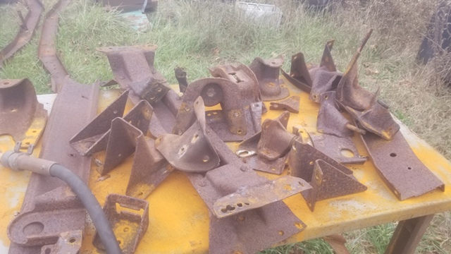

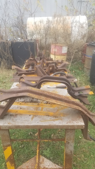

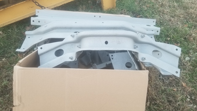

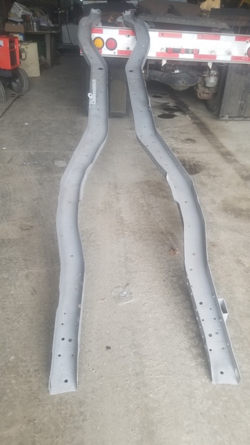

I did these last fall. First Chevy Blazer sold, (documented) in the Peoria, IL area for the 1969 model year:
Don't think there is a single fastener untouched and or replaced in this thing. Many NOS parts and many new Taiwan stampings that have been massaged and bettered for proper door gaps and alignments. Vehicle is being assembled at this writing and looks better than new.
I don't have owner's permission so not going to post the vehicle but most likely will later.
I do the same quality on tractors but it can get expensive as billed by the manhour.
