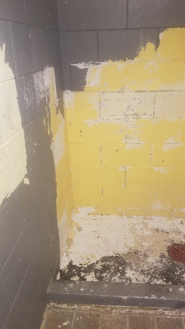

We really don't do much as far as presents and such except for the little ones. However, as a family we help each other out a lot. Photos are of my daughter, and son in law's house with a block shower in the basement. Having three females, and a single male in the household, you can relate to how important a separate shower area can be at times.....

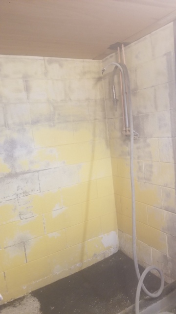

This area was painted/coated with something that paint strippers won't touch. Three different stripper types were tried as per label directions concerning coverage, and dwell time. The gray lifted fairly easily, the white with great effort and multiple applications, the yellow, not a chance. In the photos, yellow is the base applied to the block; at some point it was repainted white, and then another white coat, then ultimately the gray color which would readily peel if sprayed with hot water in places.
I elected to blast the shower area clean using a 20-40 blend of coal slag media. This is a fine grit but aggressive but the hope was to not profile the block terribly to render a smooth and consistent finish. A lot of covering of the toilet, vanity, medicine cabinet and electrical outlets with "Gorilla" tape to ensure a clean parting line when peeled off. The window sash was removed from the opening and an evacuator fan placed into the opening. Process when quite well really and very little dust in the finished basement area to clean up. There was enough room for my small blast pot, and 350# of media and still allow room to work.
Starter photos:
Job as started after they had expended several hours labor and materials:
More following.

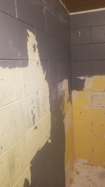

This is after starting after it with about 60psi to crack the top surface open and measure progress:
The gray, and the white color readily washed off the surface. Forgot to mention a piece of 1/4" plywood was affixed to the ceiling to not destoy that and the coating went right up to it.

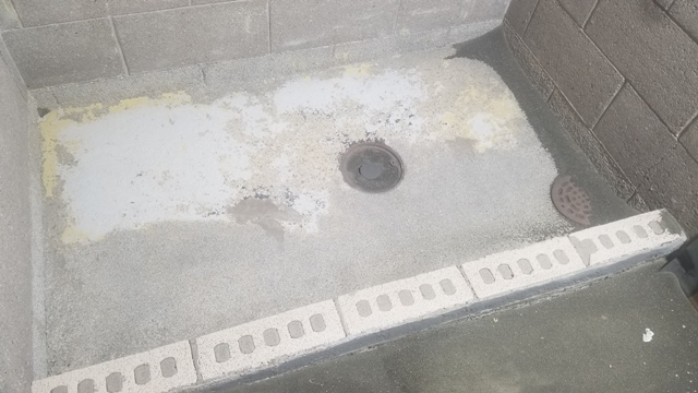

The yellow was found to be able to crack at the lower pressure but a lot of media expended to do it. Pressure was cranked up to 100psi which readily busted through it and really didn't profile the block hardly at all. I cleaned the yellow off, and then moved to the floor. Didn't photo the bare block at this point but did video close to the finished job. I'll attach that later:

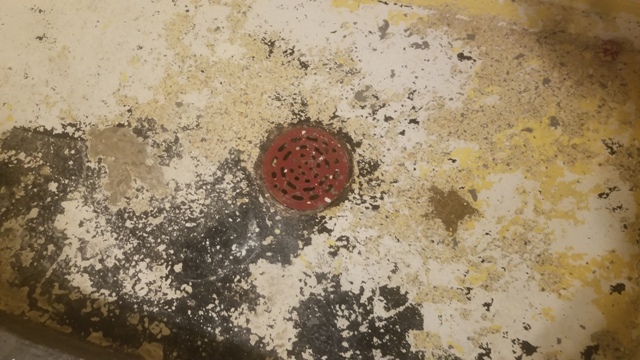

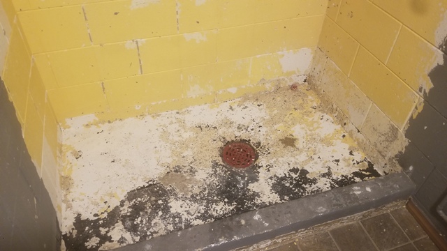

I was able to clean a good portion of the floor but under the paint was a rubberized type material that wouldn't blast clean. We will get the weed burner after it to soften, then scrape up and I'll follow with more blasting for a good "tooth" for the new epoxy base and topcoat to adhere to. The drain you see was a ball of rust as was the grate:

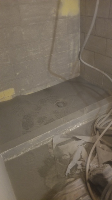

After initial blast and slight cleanup:
And pretty much as the place was left. Easy to see when the masking tape holding the plastic tarps down was peeled away, the gray and white colors came with it but leaving the yellow. That rubberized crap on the floor readily softens with heat so I'll get back over there towards the middle of the week.

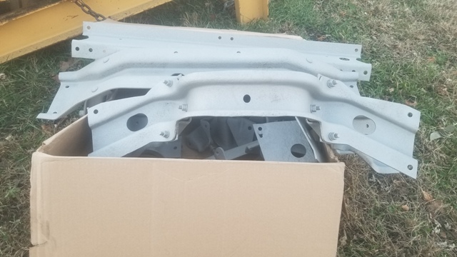

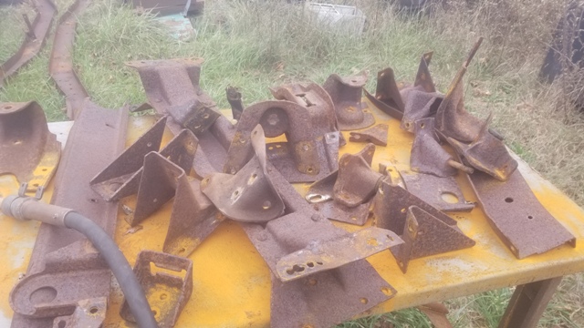

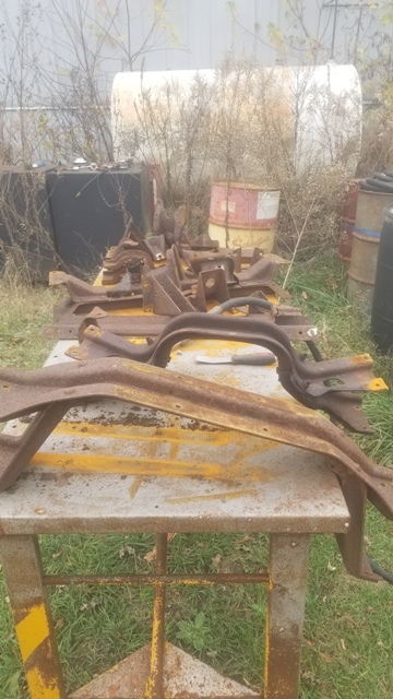

I did these last fall. First Chevy Blazer sold, (documented) in the Peoria, IL area for the 1969 model year:
Don't think there is a single fastener untouched and or replaced in this thing. Many NOS parts and many new Taiwan stampings that have been massaged and bettered for proper door gaps and alignments. Vehicle is being assembled at this writing and looks better than new.

Post Options Post Options   Thanks (0) Thanks(0)   Quote Ed (Ont) Quote  Post ReplyReply Direct Link To This Post Posted: 27 Jan 2026 at 8:33pm
Very impressive! Frame pieces look as good as new.

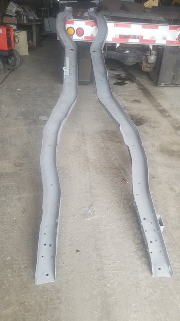

Post Options Post Options   Thanks (0) Thanks(0)   Quote Codger Quote  Post ReplyReply Direct Link To This Post Posted: 29 Jan 2026 at 10:39pm
Thanks; I try to yield good results with the blasting. Those frame rails did require some "sectioning" to repair rust thinning from Illinois roadways and the salt usage. A 1/2 ton Chevy donor frame was used for the sections and tig welded into places cut out, ground smooth, then blasted again. You really cannot tell where the repairs are after blasting again. That frame received two epoxy ground coats, then a polyester primer and was sanded smooth. It would almost pass for new once the black topcoat was applied.
