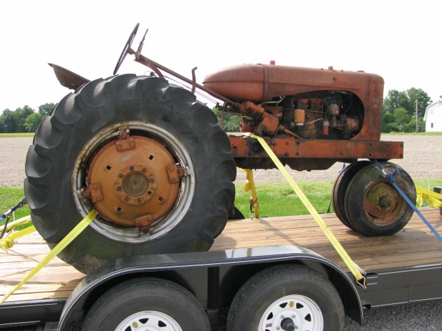

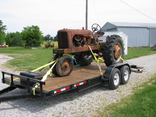

After being gone for about 10 years I got dad's WD45 back from my brother-in-law.  I was dissappointed to find out that it had been sitting outside the entire time.  Thus the factory power steering is frozen, engine is frozen and the transmission may be frozen.  The good news is the metal is straight and it was dad's.  I've got MMO in the cylinders and in the power steering gear.  This should be fun...........when it's done!  Serial number is 235216 making it a 1957 and one of the last ones made.  At some point maybe this fall I'll haul it down to Memphis and get going on it for real.

Nice tractor, were you concerned it might come off the trailer?????  :-)  Or did you just not have a place for the extra straps?

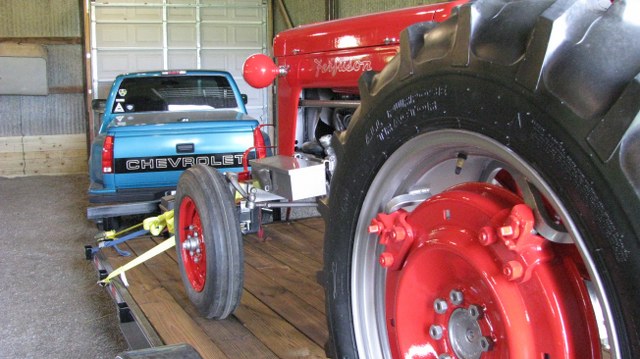

I do tend to be an overachiever when it comes to strapping.  The day before I brought the finished Ferguson back to the farm and I had 4 yellow, 4 blue and 4 red straps on it.  I was paranoid that the DOT would pull me over from all the doom and gloom talk that has been on here in the past so I was taking no chances.  LOL

I have heard the DOT is worse back East, but in either case, I don't think they would ever stop your rig, they typically aren't stopping car trailers behind pick-ups, but it can happen.  That is a good straight clean new trailer, with a simple load, as long as you weren't pulling it with a Datsun, I don't think they would look twice.  As for the Cargo straps, here is how I interpret the DOT Cargo Securement rules, other may see it differently.
That Tractor kinda falls in between the cracks, it weighs less than 10,000lbs, which is where the DOT says it turns into "Heavy Equipment"  but in the description of "heavy Equipment" they specifically list "tractors."  I believe technically it falls into the General Cargo Securing Requirements, requiring less tie downs, with less strength, but have you ever won an argument with a DOT officer???
Frankly to avoid any issue with an overzealous DOT officer, on any tractor you should use chains, with a Working Load Limit of 5000lbs, or more.  You should also use the four point tie-down method, like you did with the straps.
Technically I think you were well within the rules, but I understand you desire to not "look" like a target.

Straps...better safe than sorry is my motto... Good for ya on getting this one back and getting it looking like it should.

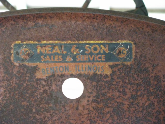

I would definitely see about ssaving this decal some how. maybe taking dimensions and such and having a copy of it put back on

That looks like a very nice project. Straight metal, good tires and best of all, a personal connection to it! Should be a labor of loveSmile I take it that your Dad was the original owner? That's a great!
I also take no chances when securing loads. I use 2" straps on the front and chains/boomers on the rear, both over-rated for the weight. I ratchet down the front straps taught and then really crank the boomers on the rear.  I'm so buffaloed by the Highway Patrol that I even check all the clearance lights before I leave! I've never been stopped; I just don't want to endure any of that grilling and ticketing process.Ouch

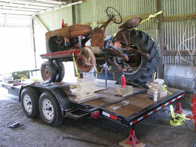

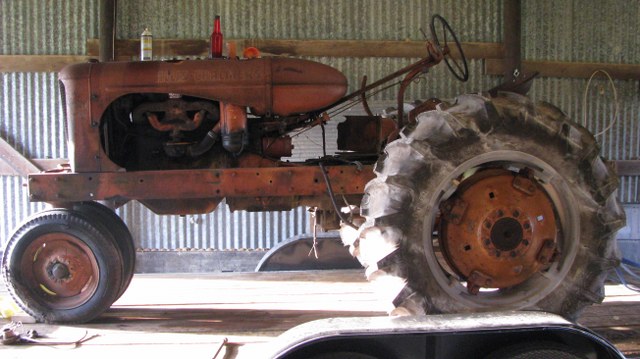

My brother-in-law had already purchased a new battery box and new Firestone tires for it on new rims and I got those with the tractor.  I told him I'd pay him what he had in them.  So the first problem was to install the new tires and I didn't want to unload the tractor to do it.  I blocked the rear of the trailer and rolled the tractor back to make the tire change easier.  The easy part was my cousins next door that had a front end loader.
Next picture shows the new rear tires on.  Their dusty but have the little tits still on them.  He bought them just after he got the tractor.
