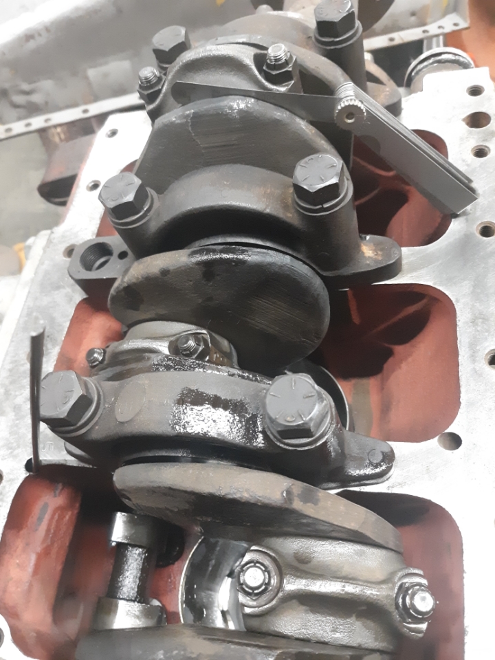

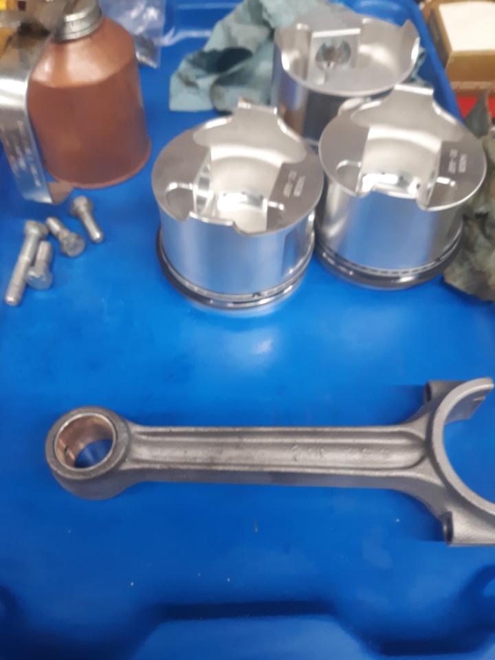

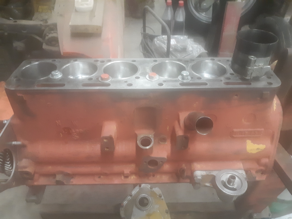

The rods came back from machine shop at last. New pin bushings installed and honed to fit new wrist pins.
Got the rods and pistons assembled and installed tonight
Rod side clearance is .004"

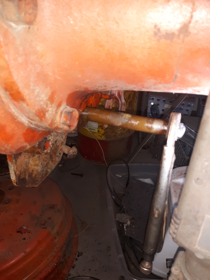

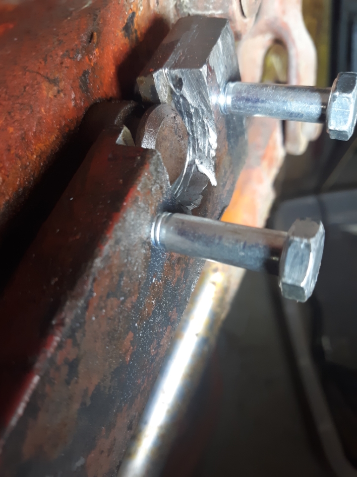

I started in on the brakes as well. Naturally the pins are stuck pretty good. I have some end mill bits so I decided to fab a pin puller using the drill press. A cross slide vise would be nice to have but managed without it. The bar stock is from some kind of brace off a McCormick something. Seems heavy enough
Remarkably, the pin was moving but I got a little overzealous and the head of the pin is starting to separate. I plan to weld it up a bit and keep at it with a bit more patience and plenty of lube. And maybe some heat.

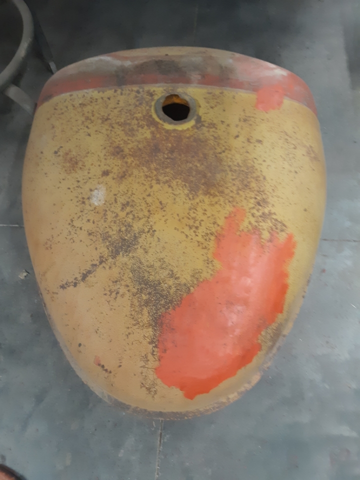

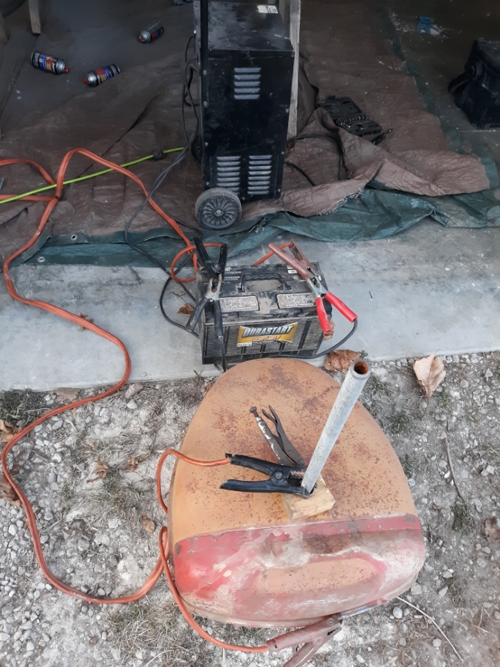

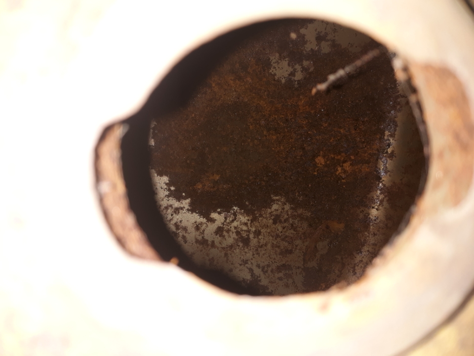

Set the fuel tank outside and set up the electrolysis to remove rust inside the tank

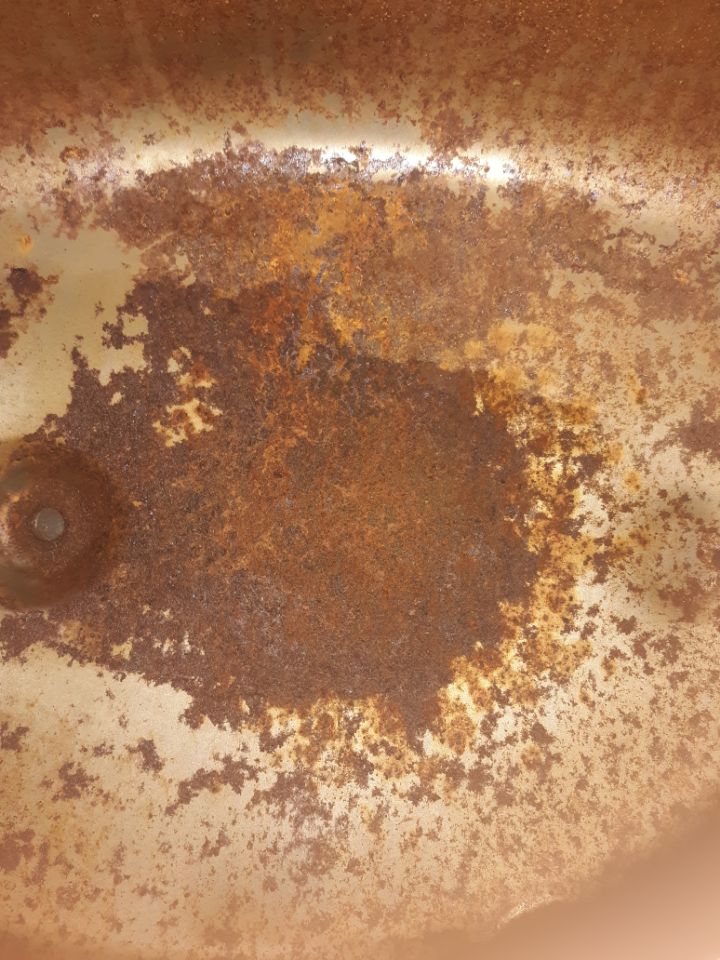

A view inside the tank.
After 24 hours there does not appear to be much rust collected on the anode yet but can see plenty of gas bubbles so it is doing something. May not be as bad as I thought. Gonna leave it cook another day and drain it. Will get it clean dry then plan to seal it.

When I replaced my brakes a few months ago on my D17 I put a large punch in through hole and banged on the pin after I soaked it with Kroil. It came loose with little effort when I put my puller n it.

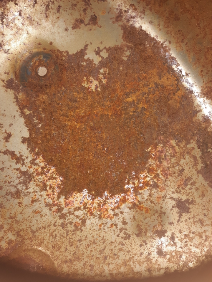

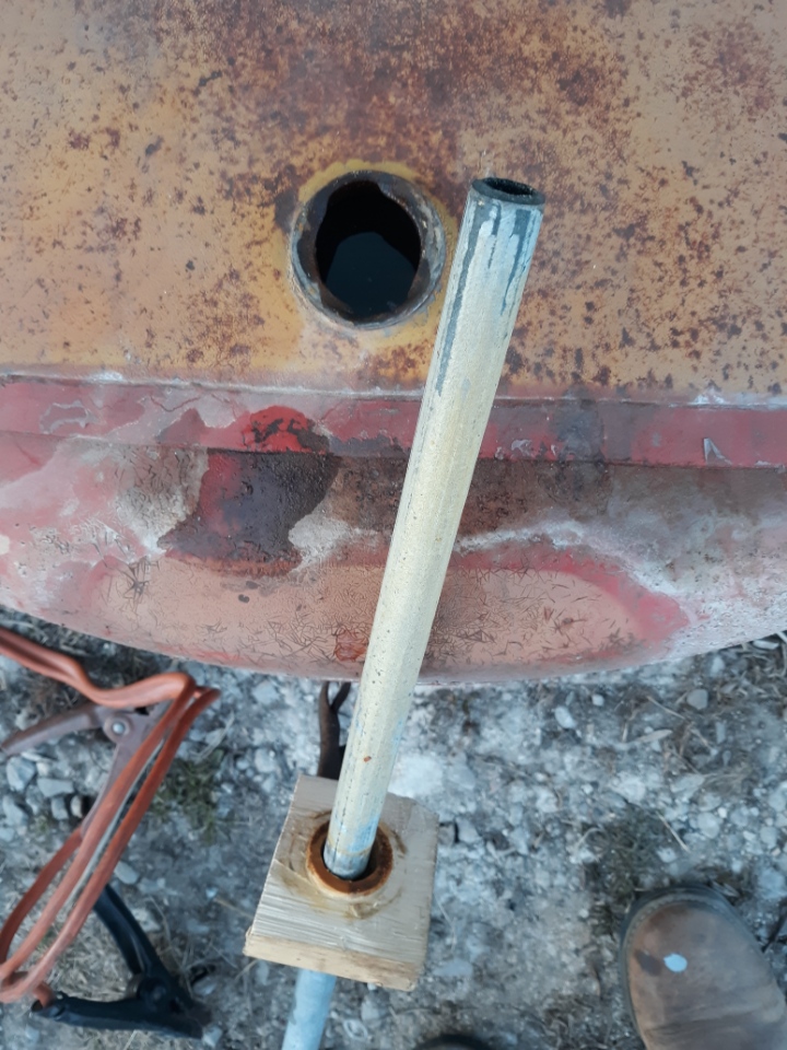

Here's the electrolysis setup on the gas tank
Not much on the anode. It's a steel pipe that had the galvanized coating ground off. Plenty of rust came out when I drained and rinsed it
Will be sealing this soon

I made a similar setup when I did the tank for WD Grandpa. Worked good.

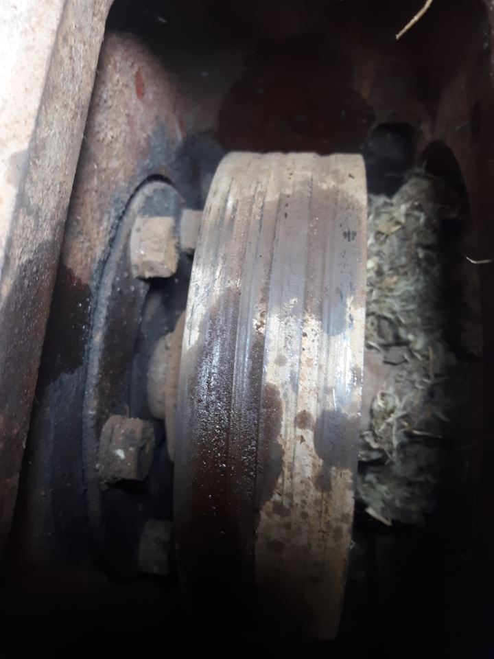

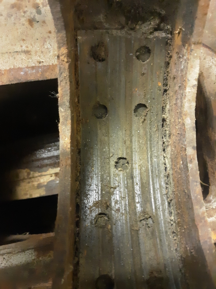

Eureka!! Got one brake pin out tonight. Welded that pin top 3 times. Moved the pin in and out multiple times keeping the penetrating oil to it. Once I was able to rotate the pin it came quite easily.
Drum and lining don't look so good though but I kinda figured that
That'll need to come apart so's I can clean out the mouse house

Post Options Post Options   Thanks (0) Thanks(0)   Quote AC720Man Quote  Post ReplyReply Direct Link To This Post Posted: 01 Apr 2023 at 11:37pm
That looks like my D17 brake drum did. A good chain hoist will become your best friend. I chose to cut off the old drum instead of pulling it. A V cut and then a wedge chisel, one smack of a hammer and it fell apart. Replaced the pinion seal while apart even though it wasn’t leaking oil.

Nice! Those pins sure can be a royal pain. I don't see any rivet heads above the lining in your pic, so someone must have changed the lining once before after the heads had dug in, then put that current lining on and it just wore into the grooves already in the drum?

My thoughts exactly. Truth be told it is likely my fault. Decades ago I was helping Dad haul manure. I pulled the spreader with this tractor while he loaded it with the WD45 with no power steering. I learned a great deal backing trailers cuz I had no power steering either and he was very specific on placement to load
Anyway, I hauled a load out and for whatever reason I had gotten off the tractor in the back of the field. When I jumped back on, put the trans in road gear and forgot to release the brake. Soon I heard a POP so I stopped to see what happened. It was then I realized what I'd and later found out that drum had split. I got an earful over that. So he replaced the drum at some point but probably held off on the lining due to budget restrictions. So I guess this is payback?
Haha, I think you're right!

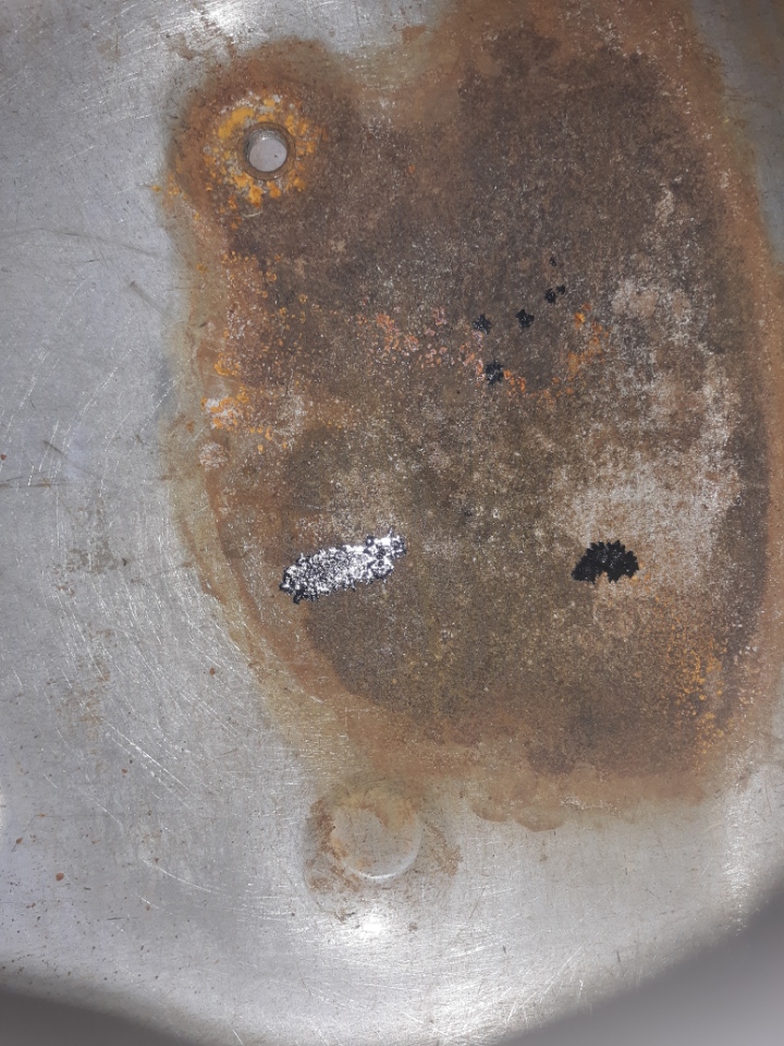

Anyway, today have started the process of cleaning the fuel tank along with the tank from the narrow front. Turns out, after all the time spent using electrolysis may not have cleaned those tanks all that well. The narrow front tank did develop some pinholes though. They were flushed then and today I poured in the cleaning solution from the kit I bought, along with a chain and swirled it around for quite some time. I was stunned how much crap came out of them. Dad's tank not too bad it didn't stain the solution much but the narrow front tank turned the clear solution dark brown and clogged the screen in the funnel when draining out. It got washed 3 times before the magnet stopped coming out dirty. Thoroughly rinsed and dried. I have them sitting in the sun to ensure it is dry before the etching step. In all, I spent over 3 hours on this first step.

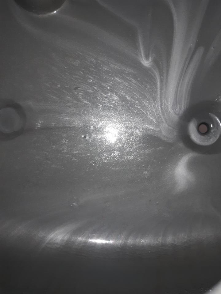

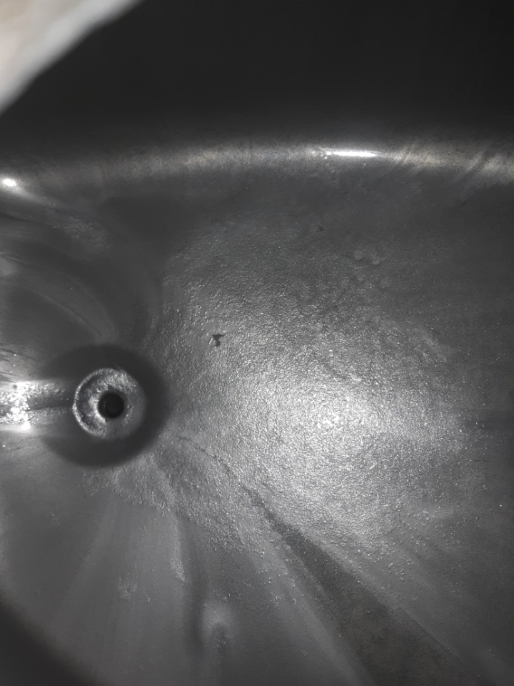

So this is the narrow front tank. You can see in first photo where I attempted to fill the pinholes using the POR15 black coating which dripped on through. After coating the inside of the tank I laid strip of fiberglass cloth over this area and soaked it down with sealer. KBS has a patch kit but thought I'd go this route. Once the sealer cures inside it should? hold?
Both tanks pre sealer. They both got the same treatment. It appears the narrow front tank cleaned up better despite having so much crud in it. The black spots are POR15 bled through.
Last picture is Dads WD tank. It had no holes in it. I got the kit that is sized for a 25 gallon tank. Figured I could treat both tanks with that. I put the fresh stuff in this tank first, then in the narrow front tank. The sealer went in and swirled around periodically for 30 minutes then the other one same process and after all that was a half quart of sealer left over
