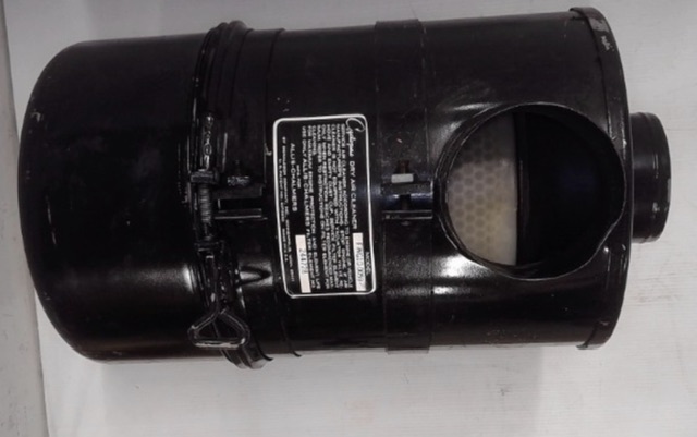

The cleaner that is in my D21 obviously isn't correct. Anybody have one? I have one that is too large to trade.

Think 70253653 is the part number. By chance is it anywhere close to a 190?

A 190 air cleaner is the same size as a 200. The one in a D-21 is bigger and the same as the one in a 220.

I believe the turbocharged D-21's got a bigger air cleaner (70253653) and it was the same as the 210/220 tractors. Older series 1 D-21's that got the factory field installed turbocharger "KIT" would have had this newer/larger air cleaner installed at the same time the turbo was added.

The air cleaner in there now is so big there is only about 7 inches to drop the dust bowl out, no way the filter is comming out.

Have you tried it? It's tight on my 220 but will cock and come out.

That’s the way na 21s were

Sounds like you have the right filter assembly.  It looks like a tight fit, but the filter will come out.

About 6.5 inches from bottom of cup to front surround on my 220

And the filter comes out? I guess that is what iam seeing

You need to actually try it before saying it won't work. The filter is smaller in diameter than the can so it has room to tilt and come out.

Mike do you actually have that complete housing?
