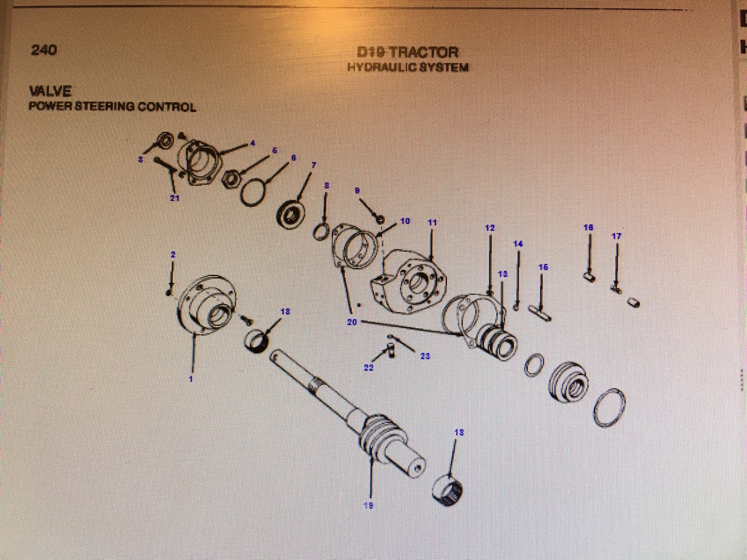

Which parts do I need? Doesn’t list a seal kit, and I don’t have a service manual yet, unless it will be the same as a d17.

All orings and # 3 seal.     MACK
