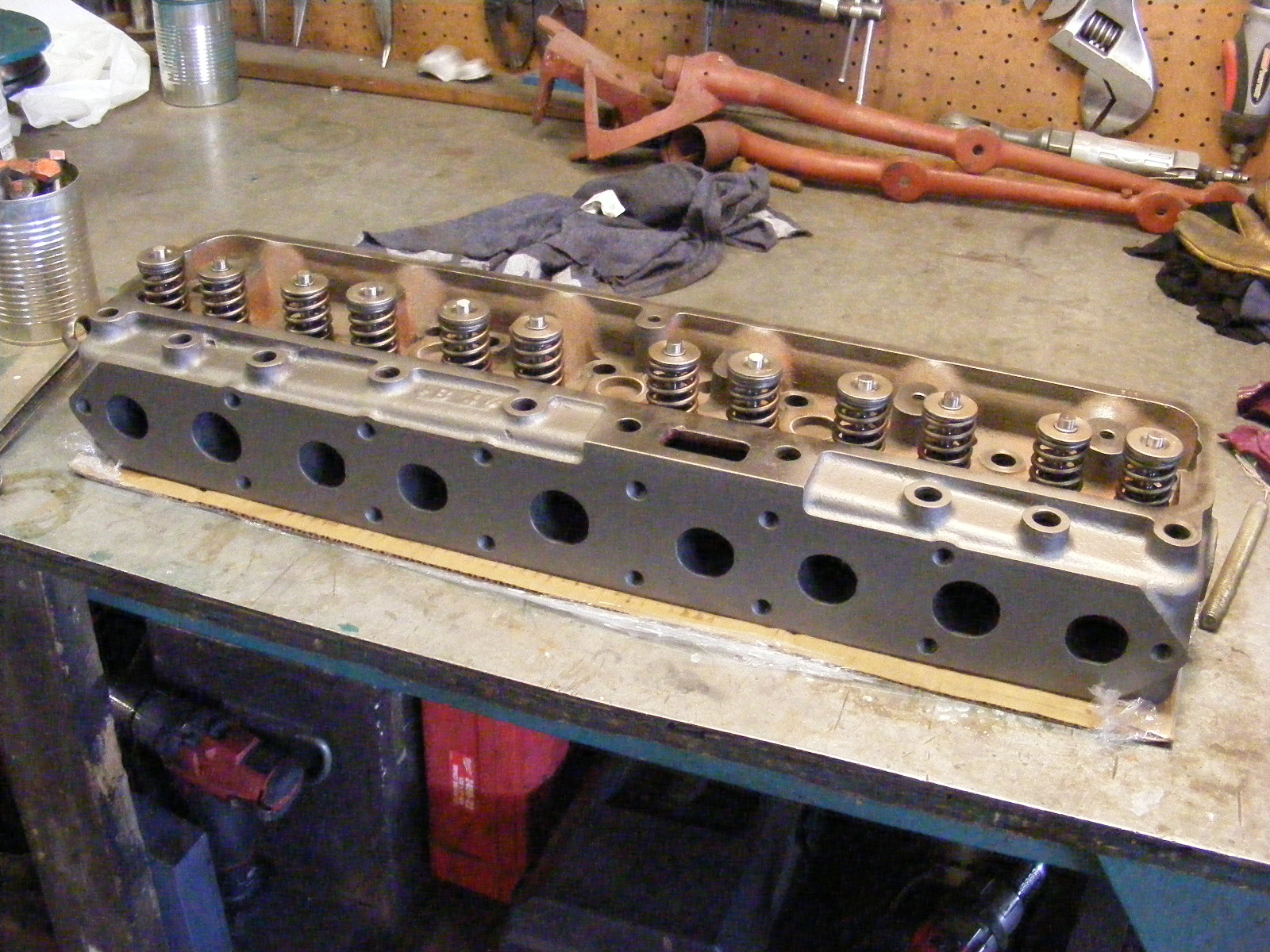

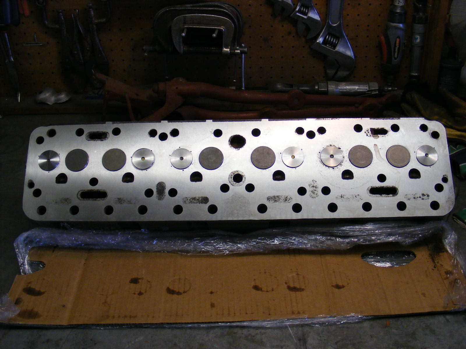

Post Options Post Options   Thanks (0) Thanks(0)   Quote Alberta Phil Quote  Post ReplyReply Direct Link To This Post Posted: 11 Apr 2020 at 6:14pm
I had some old studs of the right size on my used parts and used those to line up the gasket and head.  Engine was very good shape except for valves.  I got new valves and springs from Sandy Lake and my local engine shop put the head all together with new exhaust inserts and seals.  They always do excellent work and I've been using them for years.

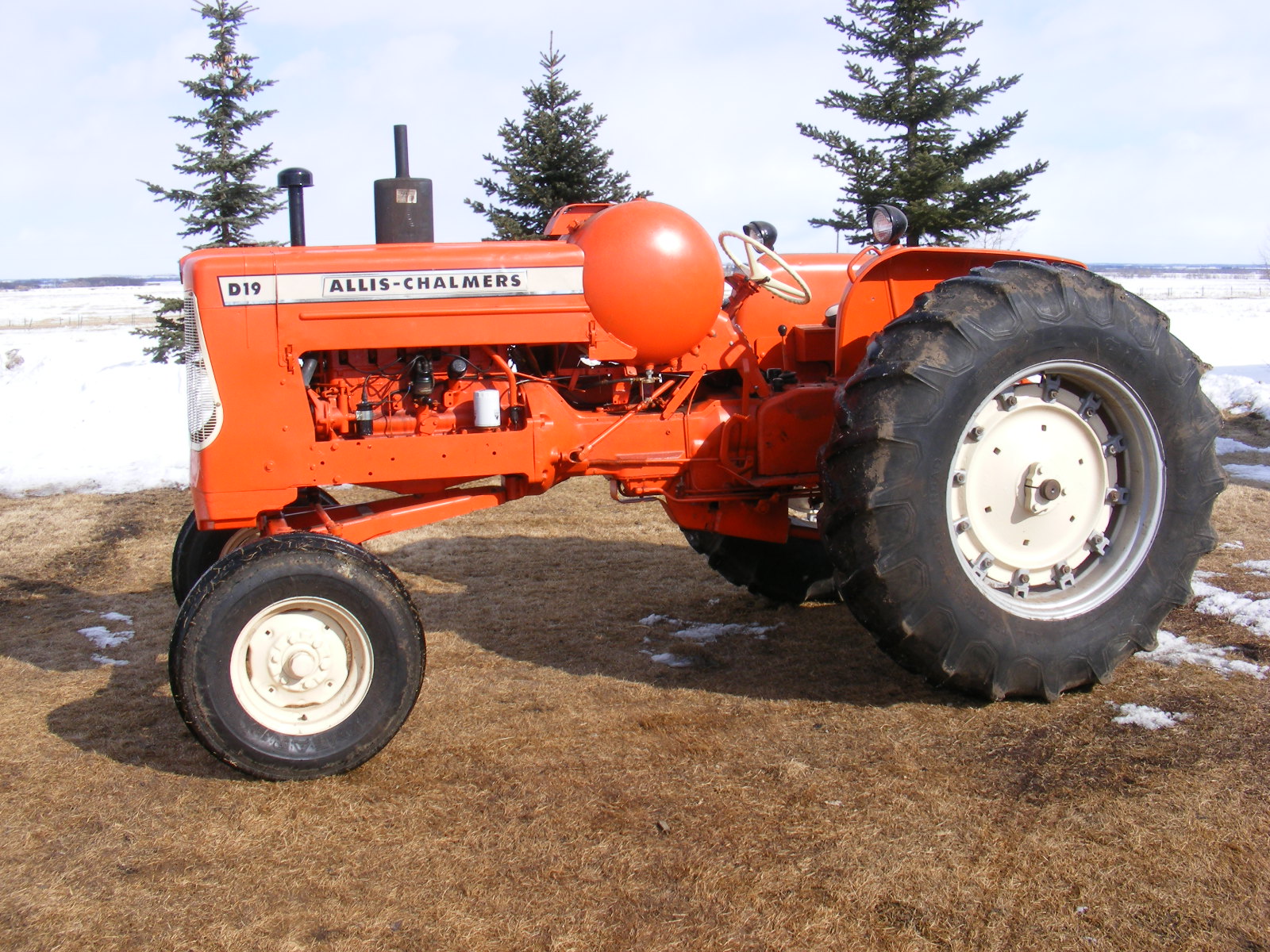

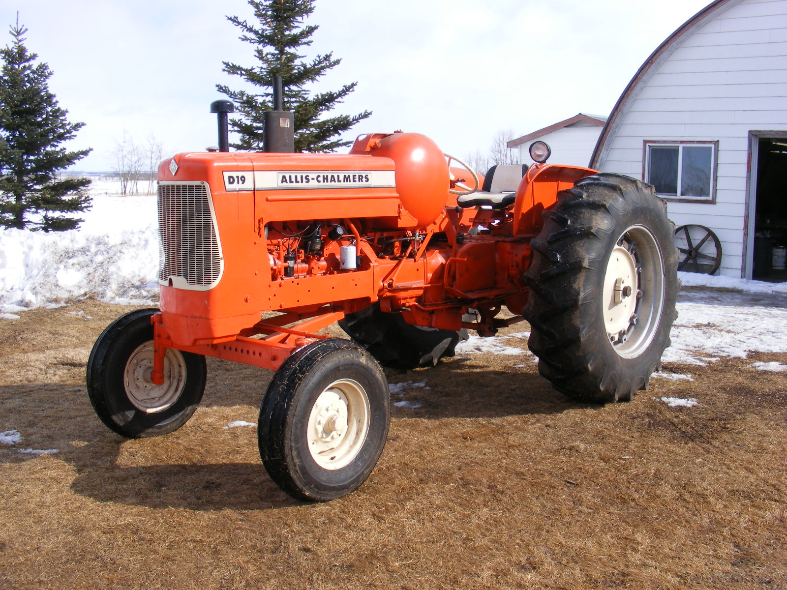

Finished the tractor today including installation of a new alternator.  Kudos to Steve at B&B for helping me sort out the wiring.  All is working like it should now!!  Here is a couple of pics of the tractor.  It's a pretty nice unit, originally LP, now converted to gas.  Belongs to one of my neighbors who bought it new.

Post Options Post Options   Thanks (0) Thanks(0)   Quote TedBuiskerN.IL. Quote  Post ReplyReply Direct Link To This Post Posted: 12 Apr 2020 at 7:18pm
May I ask why you converted it to gas?  I have a D19 LP, and a 190xt LP and I love'em. I think the 190 may be rare.
Alberta Phil View Drop Down
Location: Alberta, Canada
Points: 3929
Post Options Post Options   Thanks (0) Thanks(0)   Quote Alberta Phil Quote  Post ReplyReply Direct Link To This Post Posted: 12 Apr 2020 at 9:37pm
I don't know why it was converted to gas.  I'll ask my customer when he comes by tomorrow to pick up the tractor.
I have a nice D17 LP with a factory loader and just love it the way it is.
Points: 3929
Post Options Post Options   Thanks (0) Thanks(0)   Quote Alberta Phil Quote  Post ReplyReply Direct Link To This Post Posted: 13 Apr 2020 at 2:22pm
Ted, I asked my customer why they converted and he told me "years ago they had a large propane tank on the farm for heating.  Later, they had natural gas piped in as most do around here, and so they no longer needed the big tank.  All the other tractors and equipment on the farm was either gas or diesel and they had bulk tanks for both, so it was just for convenience that it was converted."
