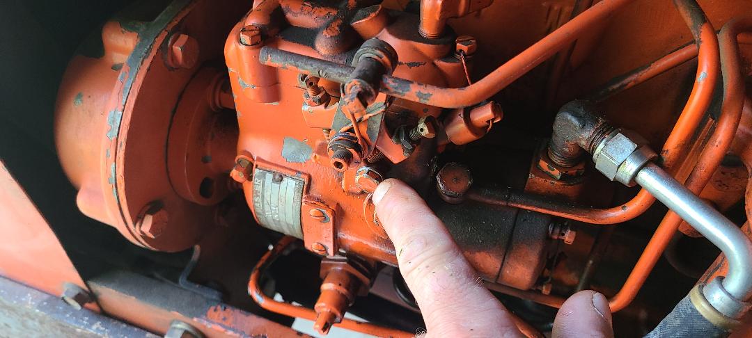

Post Options Post Options   Thanks (0) Thanks(0)   Quote nowaktj Quote  Post ReplyReply Direct Link To This Post Posted: 11 Oct 2021 at 8:39am
Thanks for the input.
I took off the fuel line on top of the pump and fuel does dribble out of the line.
I removed the 7/16" headed plug shown in the pic below and fuel does run out of that port.

Post Options Post Options   Thanks (0) Thanks(0)   Quote injpumpEd Quote  Post ReplyReply Direct Link To This Post Posted: 11 Oct 2021 at 9:58am
those are just housing fuel on the return side. Fuel coming out there while cranking is a good thing, it means the head is not seized and is turning the transfer pump. Bad part is, it still needs properly torn down and cleaned up.
