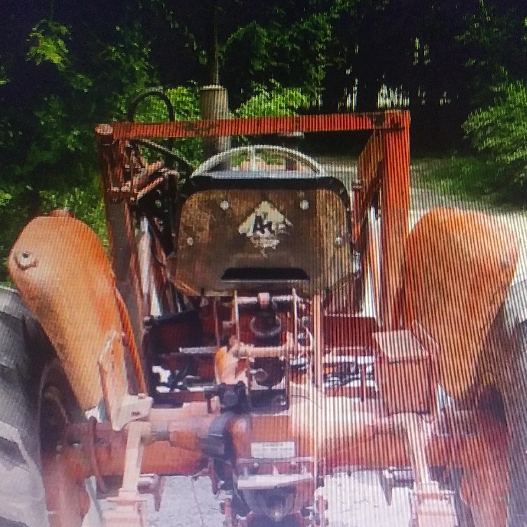

Picture of my d17 IV from the back, black pan seat but you can zoom in and see the location of the decal.

Different decal for cream seat. The "Allis-Chalmers" decal is positioned half-way between the top edge of the seat pan and the cross ways slot below.

Well I guess I didn’t realize there was a difference. We just picked up a new seat at a show few weeks ago. New seat is cream frame. I got the decal per the part number from parts book and it’s like the one above in picture on black frame.

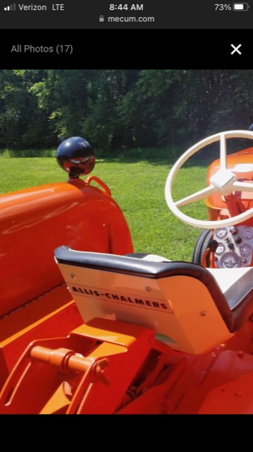

Is this the right one?

That's (I think) the only one I've ever seen on the cream seat pan. This would be prior to the logo change, which happened with the black seat pan in 1965/66 ??

Ok thanks. Our 17 is 78307 1965. What about D15ll. Sr 20668 1965

The “New” logo was introduced in ‘65

Very late in 1965 actually.  A change promoted for the 1966 model year.  My neighbor had a late 1965 D17 IV with the sunburst emblems on it (not repainted).
