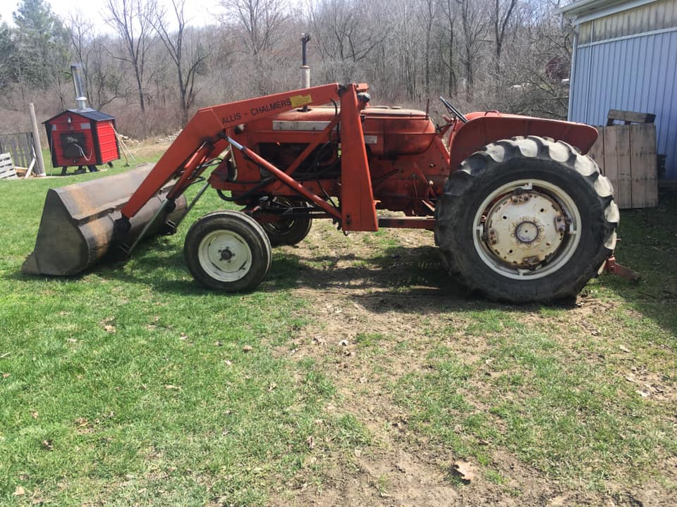

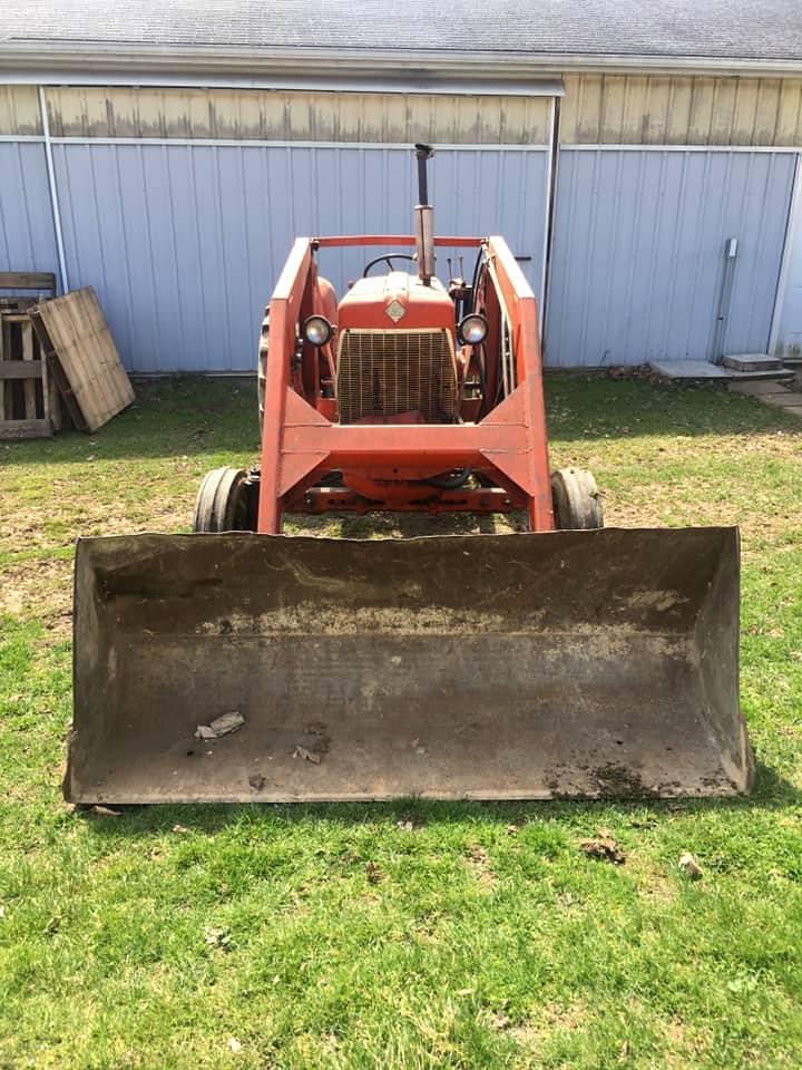

Thats the one I am looking at

It's a good combination of a rugged tractor and rugged loader. It is old. Be sure to operate it for at least 30 minutes and wide open throttle as much a possible. Any blue smoke coming from the exhaust pipe means it is an oil burner.....beware.

Wishing you luck on your D17 purchase. As others have mentioned they can be good to poor condition? If you do get a chance to run it for a while that would tell you some things about how it operates too. When I bought mine, at a auction, I had time to check it out not running and then it was only started for about 10 seconds and shut down. I took a chance. Mine turned out good. I have gotten other tractors that were not very good at all.
Tires are sometimes worth as much as the tractor. Those rears look good!
Loader would be handy too.

It looks like an AC 500 loader mounted on an early AC D17. That model loader could be outfitted for D17s, D17IVs, & D19s. For the early D17s, it was furnished with an optional separate hydraulic system(front hydraulic pump, oil reservoir inside left vertical frame, vavle bodies, & rear extended hydraulic valve levers. You can see these items in the later photos.
The loader also was offered with maure buckets in 42", 60", & 72" sizes. Material buckets offered in 42" (10.75cu.ft) and 60" (17.5cu.ft) capacities. A light material bucket of 80" (23.65cu.ft) capacity. The dozer blade(heavy duty) is 80" width.
Loader's pump capacity was 11gpm @1650rpms(D17 tractor's full throttle).
Loader's front pump has 2000 psi max. Loader's oil screen is located in bottom of it's frame reservoir. Unless dealership installed an additional inline hydraulic filter, this screen is the system's only filter. For D17 model prior serial number 15931, the front mounted hydraulic pump is coupled by a chain coupler to an auxiliary pump drive shaft that splines into a 4 bolt hub that bolts to front of engine crankshaft pulley no. 230966. A pump guard covered to protect pump.
Loader lift capacity: 2300lbs full lift, 3400lbs carrying @3' height, 4000lbs breakaway force.
For reference when you demo it, the loader cycle times are as follows:
Cycle time up: 5.0 seconds,
Cycle time down: 2.4 seconds
To check loader oil level, raise loader to max height, then lower loader so its sets flat. Remove sump oil cap and add oil if required so oil level is at mark on dipstick in sump cap. Use SAE 10 oil, non foaming, high viscosity index, and high oxidation resistance.
Since its a loader tractor, it's rear tires are probably fluid filled for ballast. So check it's rear rims for rust, especially around valve stems.
Best of luck. Good loader rig, if maintained & not abused.

That would be a 400 Series Loader since the Hyd. Oil Reservoir is in the L/H Frame.
You can see the Fill / Breather Spout and the 2 Hyd. Cylinder Control Levers.
Also the Front Mounted Pump and Pump Guard.
The 500 Series Loader was used on D-17 Series IV with Live Hydraulic.
Gary
Post Options Post Options   Thanks (0) Thanks(0)   Quote DrAllis Quote  Post ReplyReply Direct Link To This Post Posted: 16 Apr 2020 at 11:59am
I would say it is a 500 loader by how tall the towers are over the top of the hood.
Edited by DrAllis - 16 Apr 2020 at 11:59am

According to the manual I have, the frame is the same for both 400 and 500 series loaders.
I take that back........they do have different part numbers!
Edited by Brian G. NY - 16 Apr 2020 at 4:21pm

400 loader on a 5040
On this loader, the oil reservoir/tank is on the right-hand column; black fill cap visible.
Maybe the difference from the 500 is in the Lift Arm length and corresponding Lift Cylinders & Bucket Cylinders length
Edited by Gatz in NE - 16 Apr 2020 at 4:17pm

AC 400 loader - maybe?
Ewitford, the previous AC 500 loader specs that I shared came directly from my genuine Allis-Chalmers 500 loader Operating Instructions book shown in the photo below.  My AC 500 loader is mounted on an early AC One-Seventy. It's 500 loader completely shares the One-Seventy's hydraulic system, much like described in this book for the D17IV. So, it does not have the auxiliary front pump like the D17/loader that you're considering.
My 500's lift cylinders leaked & a seal kits could not completely fix it's bent rams. Also some of it's pivot pin bushings wore too thin, probably not greased regularly. They are housed inside a casting that is welded into the ends of the loader arm rectangular tubes. A close inspection should offer insights of it's previous maintenance.
Norm's book says the 400/500 loaders were introduced in 1963. The 400 fit the One-Sixty,5040,5050,& 5045. The 500 fit the D17III, D19(with auxiliary pump), D17IV, and all hundred series from One-Seventy thru 200. But who's to say - things could get swapped?
Post Options Post Options   Thanks (0) Thanks(0)   Quote DrAllis Quote  Post ReplyReply Direct Link To This Post Posted: 17 Apr 2020 at 11:16am
But, a 400 loader on a D-17 has the crossbar just a couple of inches above the hood. The 500 like in your picture (and on the tractor/loader in question) is 6 inches above the hood.

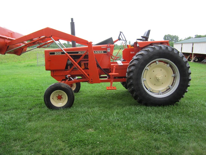

Here is my 200 with a loader. My retired AC dealer said it was a 500 loader.
Post Options Post Options   Thanks (0) Thanks(0)   Quote DrAllis Quote  Post ReplyReply Direct Link To This Post Posted: 17 Apr 2020 at 12:09pm
And he would be correct. A 400 loader doesn't fit D-19's, 180-185-190-200's.

It has a Saginaw three point adapter.  Great stabilizer setup on it.  Check around the valve stems on the rear rims for corrosion.
I totally agree and appreciate your additional insights about them.
Gary Yesterday’s reply seemed adamant about it being a 400. I’ve never owned a 400, so I have little to no comparisons to offer.
That said, I Looked deeper into my AC literatures to help me understand any differences. What I learned was interesting & just wanted to share.
