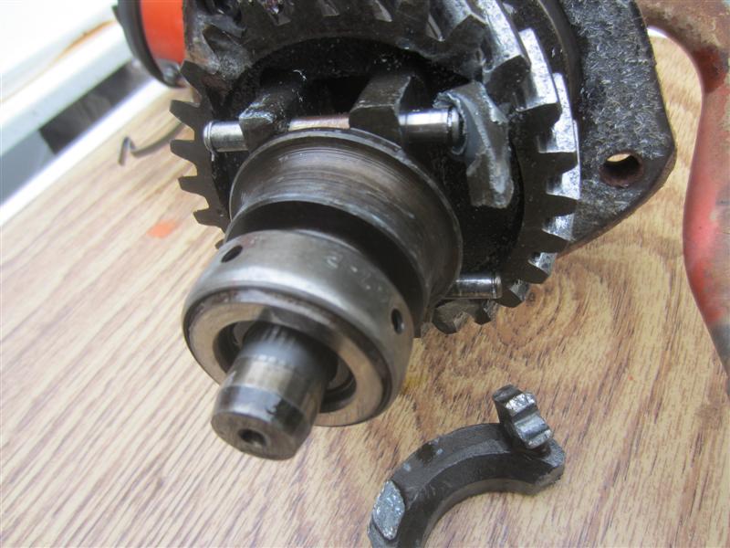

Does anyone have a picture of the governor spring on a d17 series 3? located under the battery, where the throttle cable links to the governor rod. something doesnt seem to be working right with mine. Tractor doesn't want to idle down, and when I throttle up it immediately goes to high rpms. any advice ?

That spring isn't causing the problem. I think your governor weights have exploded.
x2.

The function of that spring that sits under the gas tank is to make the throttle lever pull down easier when you get half-way down or more. It is an assist to make the linkage work easier. By your own description, the governor weights possibly have exploded. That spring under the gas tank can be missing completely and the engine will still idle down slow and not run away by over revving. My opinion is based on what you have told us and 50 years of D-17 experience.

gov wts and pins don't last forever

X3.....' happened to my D17 Series 2 a few years ago.
Things do wear out.
