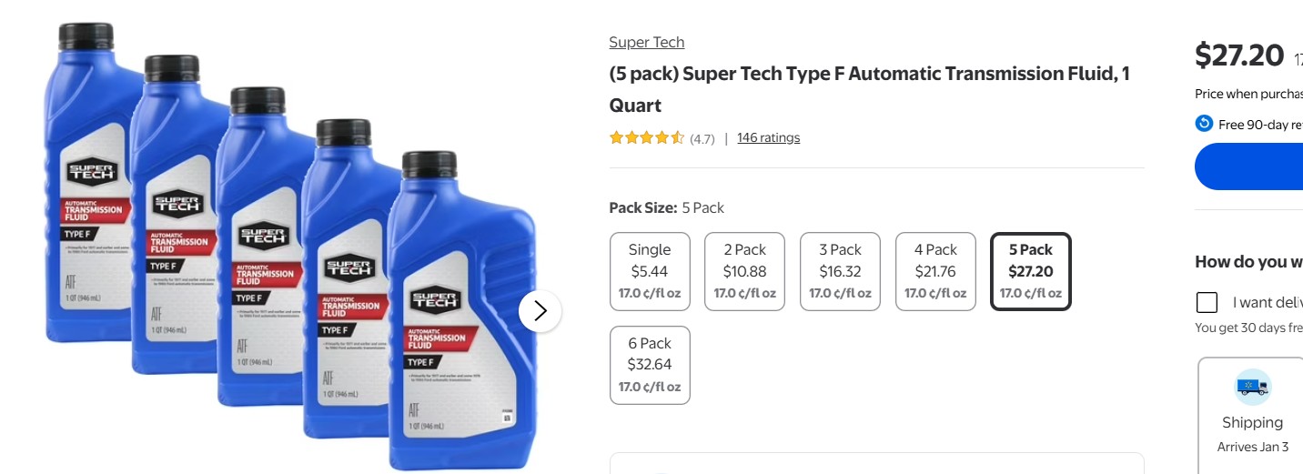

yes.. probably some moisture in the old oil. Changing it out would definitely help..
As cold as it is, the thinnest oil you can get would be best. Transmission fluid is normally thinner than most UTF  / Tractor fluids.... I would go with a Type "F" or type "A" or any older type you can find.. I might stay away from the newer MERCON LV and DEXRON VI as they are synthetic and have a lot of extra "addatives" that may not be good on an older system.
Edited by steve(ill) - 29 Dec 2025 at 9:52pm
Points: 90599
Post Options Post Options   Thanks (0) Thanks(0)   Quote steve(ill) Quote  Post ReplyReply Direct Link To This Post Posted: 29 Dec 2025 at 4:48pm
here is one option at local Wal Mart...
