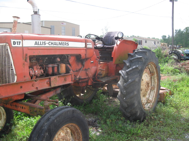

Here is a photo of the tractor with the steering problem.
pied View Drop Down
Joined: 26 Mar 2012
Location: Southeast, LA.
Points: 8
Post Options Post Options   Thanks (0) Thanks(0)   Quote pied Quote  Post ReplyReply Direct Link To This Post Posted: 27 Mar 2012 at 2:29pm
    I had problems on the photo upload but that is the tractor with the steering problem. It became mine when my son died in a hunting accident. I have had no experiences with tractors till now and I am appreciating all of the information everyone is giving. I'm trying to get it into shape and will keep it in memory of Jason.  In the background is the other tractor, a Ford 3000. I know very little about it also but will tackle that project after this one.  It's good to know that I have people out there that know everything about tractors!  THANKS!!!!!
