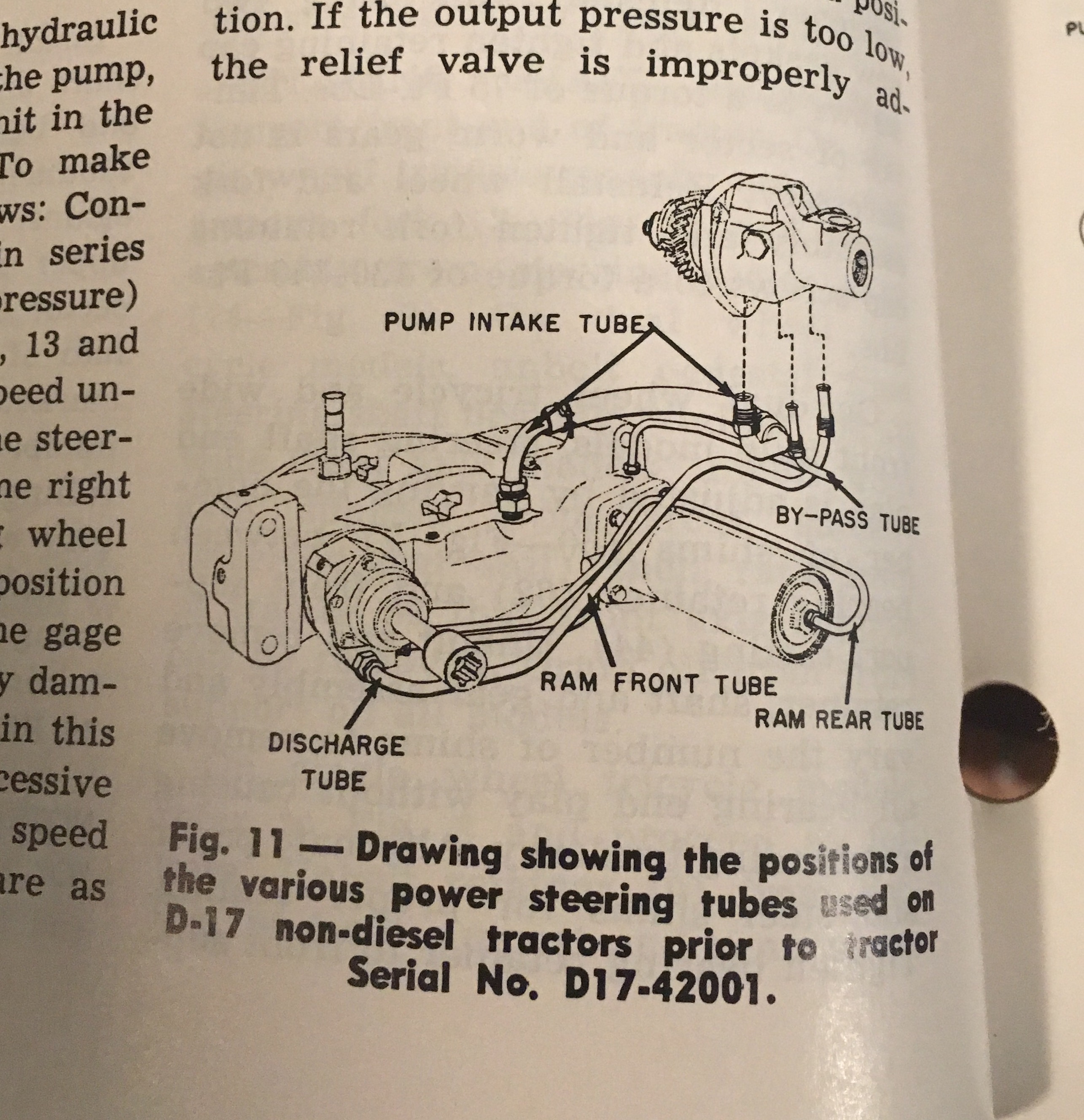

Pic1:
Not familiar with the highlighted sheet metal??? WaZ that??

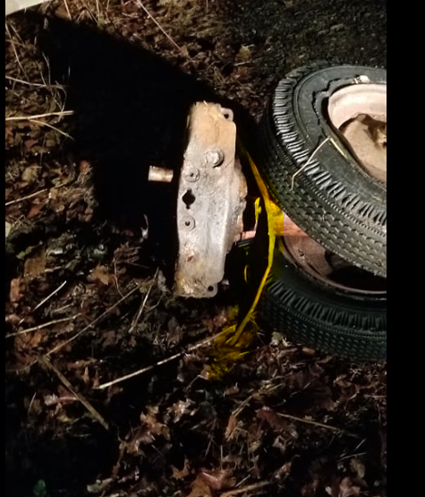

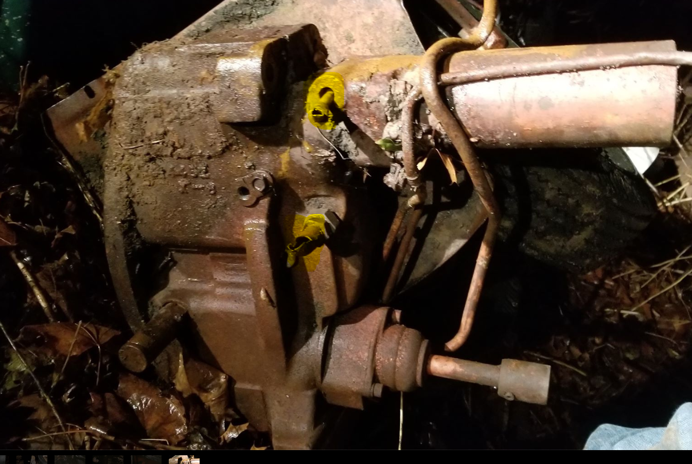

Second pic:
Ok that cylinder thing has to do with powersteering?  The two highlighted tubes; hard to replace?

Ok is that part visible in my pics?

Post Options Post Options   Thanks (0) Thanks(0)   Quote wade89 Quote  Post ReplyReply Direct Link To This Post Posted: 30 Dec 2019 at 7:55pm

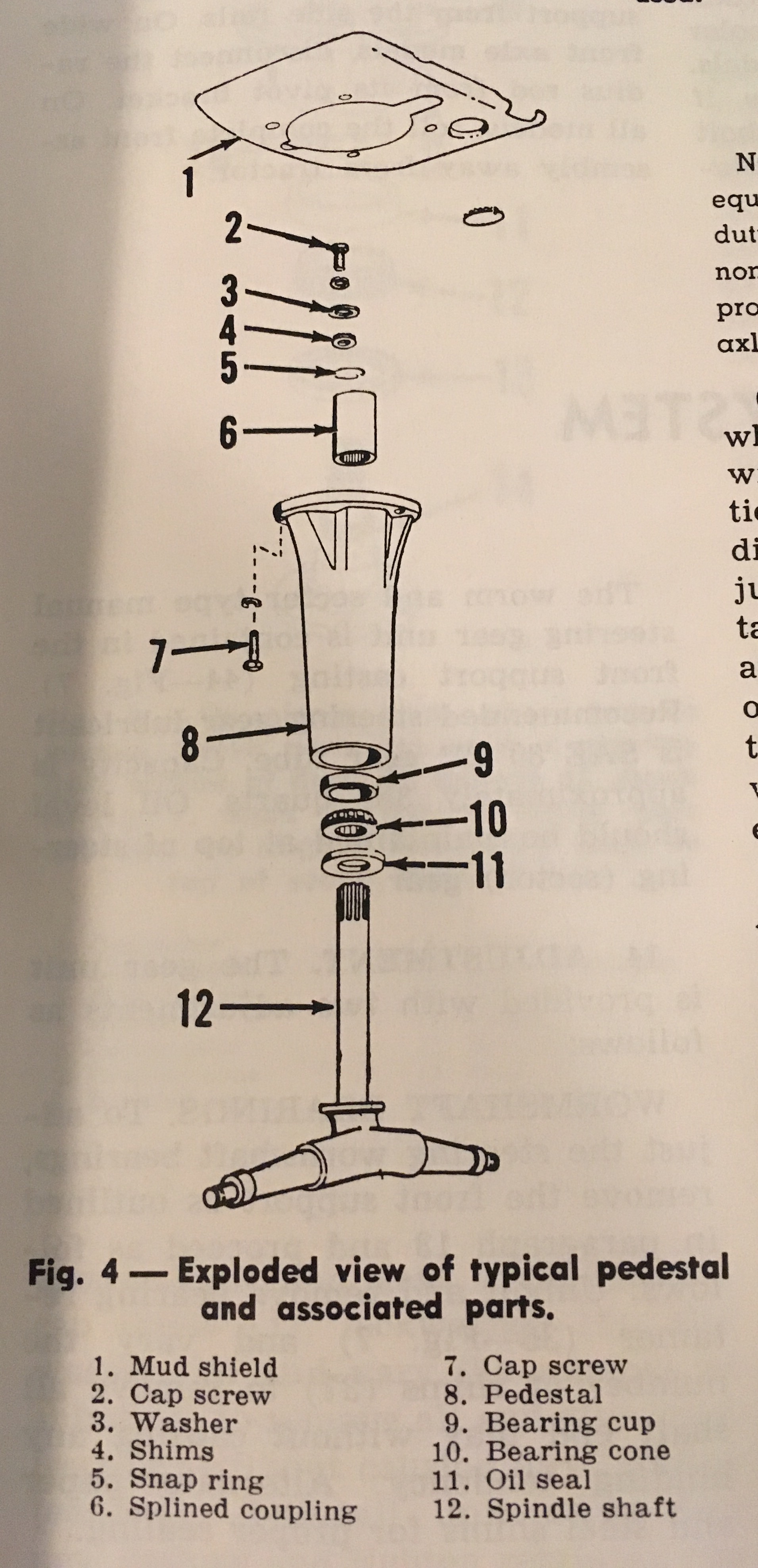

Yeah and the piece of tin in the first picture is the "mud shield"

Thanks Wade..
So the "narrow bolster casting" is part #8?

Tom, do you want the power steering, the narrow front, or both? I changed my power steering last summer (everything in first pic). From my research, they're all the same box. If You take coupler #6 off from the 2nd pic along with everything below it, you can slide the yolk for a wide front on the splined shaft it comes off of.

I would take it all...I hope to get a D17 IV someday, and doubt would find a NF. So I here would have one ready to go.   So what part # is the bolster?

"Bolster" is basically everything in the 2nd picture
