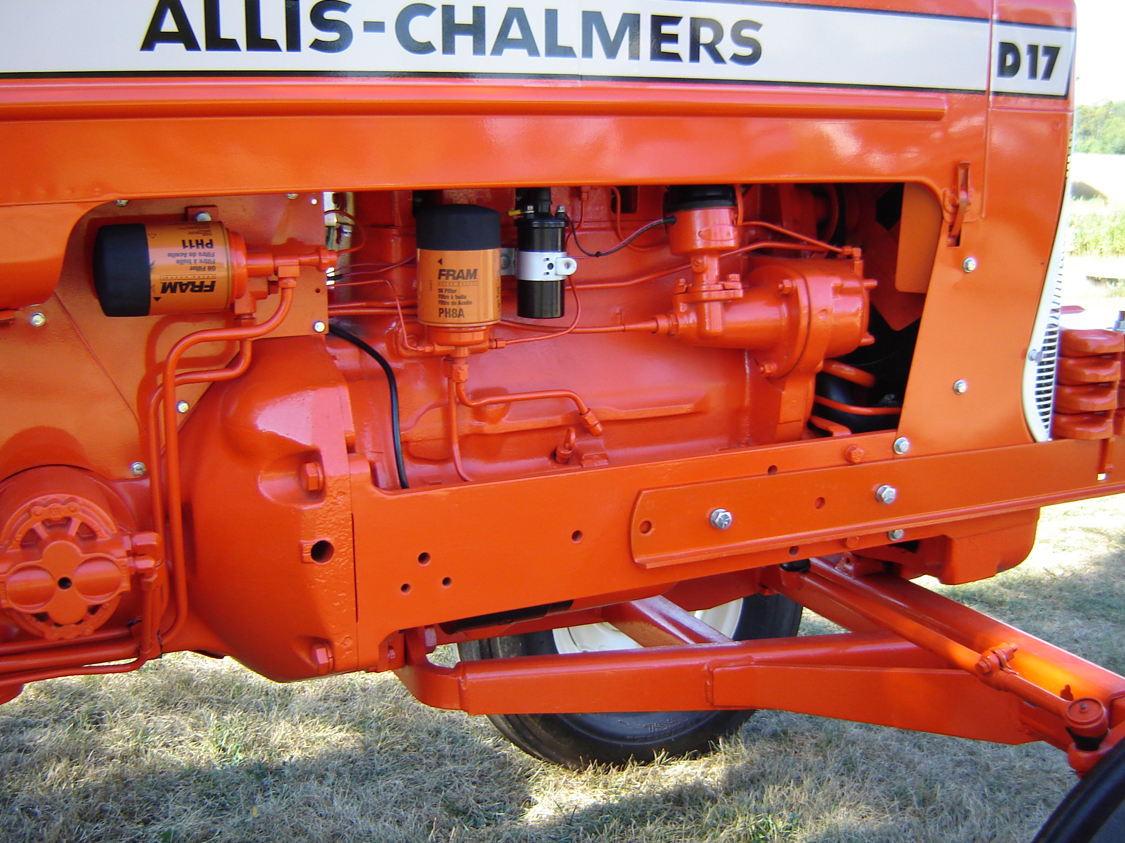

A lot of people put series 4 decals on tractors that are not series 4.  True series 4 tractors have a side mounted hydraulic pump (below the fuel tank).  Earlier series did not.  No major changes in the engines throughout the D17 production run though.

Early production D17s used the low pressure, WD style oiling system. I don't remember what year the full flow system was introduced. 1960 maybe???
