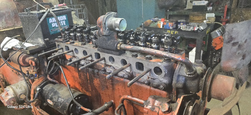

Fresh valve job. Ready to go.
Just recieved intake valve seals yesterday and reassembled head last evening....
Should have it running in the next few days....

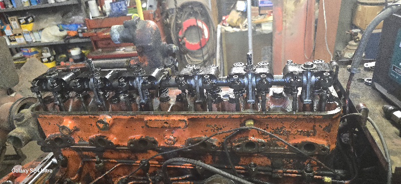

Getting closer...

Warmed it up to temperature...
Re-torqued the head, reset the valves......
