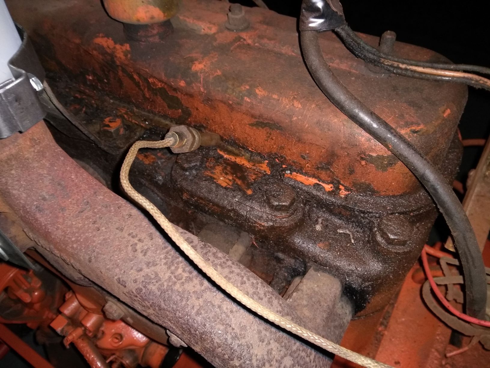

Could you guys post of photo if this location thatd be great having trouble finding it as well

I just purchased a D17 Series I and the temperature sensor is hanging loose.  I, too, was having trouble finding the port to screw it into.  The following helped me...
http://i233.photobucket.com/albums/ee170/Sugarmaker/D17_3_26_16/DSC05274.jpg
which is posted in this forum thread on page 2.
https://www.allischalmers.com/forum/1958-d17-nfe-lots-of-pictures_topic120919_page1.html
When I went to this location on my D17, I find that there is no port - it is just covered with a plate.
If someone can point me to a place where I could purchase the port adapter, I would appreciate it.

Used one from a tractor salvage yard off all the D17 gas tractors and off the "E" Gleaner combines will work.
