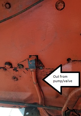

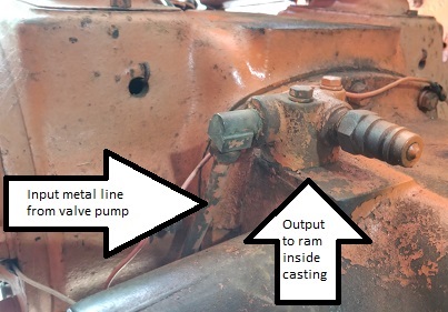

1957 D17 Series I: Is the flow of the hydraulic from the pump/valve body up through the external steel lines to the distribution block on the rear casting behind the seat? See Pics. Yes I have all three manuals--Operators, AC Service and the infamous IT--but I want to confirm before adding valve body. Have a slow drift down of lift arms under load. Possible worn levers/out of adjustment or worn internal control valve.

The external line you are pointing to is the return line.  Everything else is internal.  If your arms are drifting down, it could be the seal in the lift cylinder or the line inside the tractor.  Either way, nothing on the outside of the tractor will solve the problem.

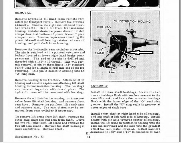

Still not grasping the concept. What does that internal flexible hose leading to and from the ram connect to? I was assuming that was the source of the oil powering the ram. Since it is a ram--no down pressure-- I was making the assumption the flow goes to and from in the same line. If that isn't the case how does it become pressurized to lift?

The steel line directs oil from the pump to the lift arms or lift cylinder on an implement to lift a load. The pump has a hold valve built into it. No adjustment. The steel line holds the oil when the pump is in HOLD. When you lower anything, the hold valve on the pump opens and the oil returns back thru the steel line the other way. Having trouble holding an implement or lift arms??  #1. a bad hose inside the lift arm housing. #2. leaking seals on the lift arm cylinder inside the lift arm housing. BOTH of these will cause oil level to go up in the transmission and down in the hydraulic compartment.  #3. A bad hold valve on the pump. Three things. And the only things it can be for leaking down.
