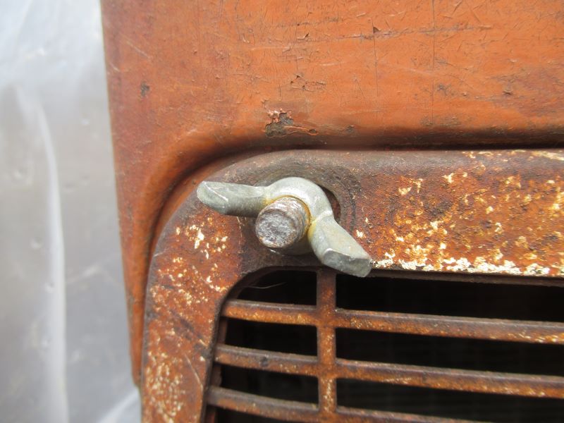

These are the factor style thumb screws.
The wing nuts should be the flanged ones.

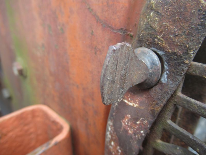

I think it should be 5/16 dia. Coarse threaded? Just try a bolt that size in the treaded hole and see if it works. I believe the early D series used different style head on the thumb screw than the later models. One was fancier. You can get them on ebay or most aftermarket dealers but they get a little pricey. I think my local ACE hardware store carries the plain standard kind for about a $1.50 or so a piece.
