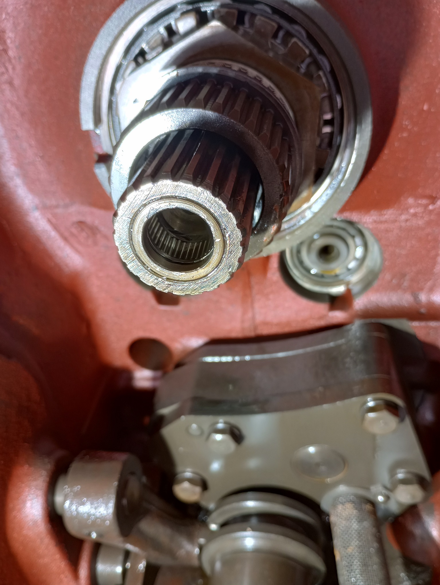

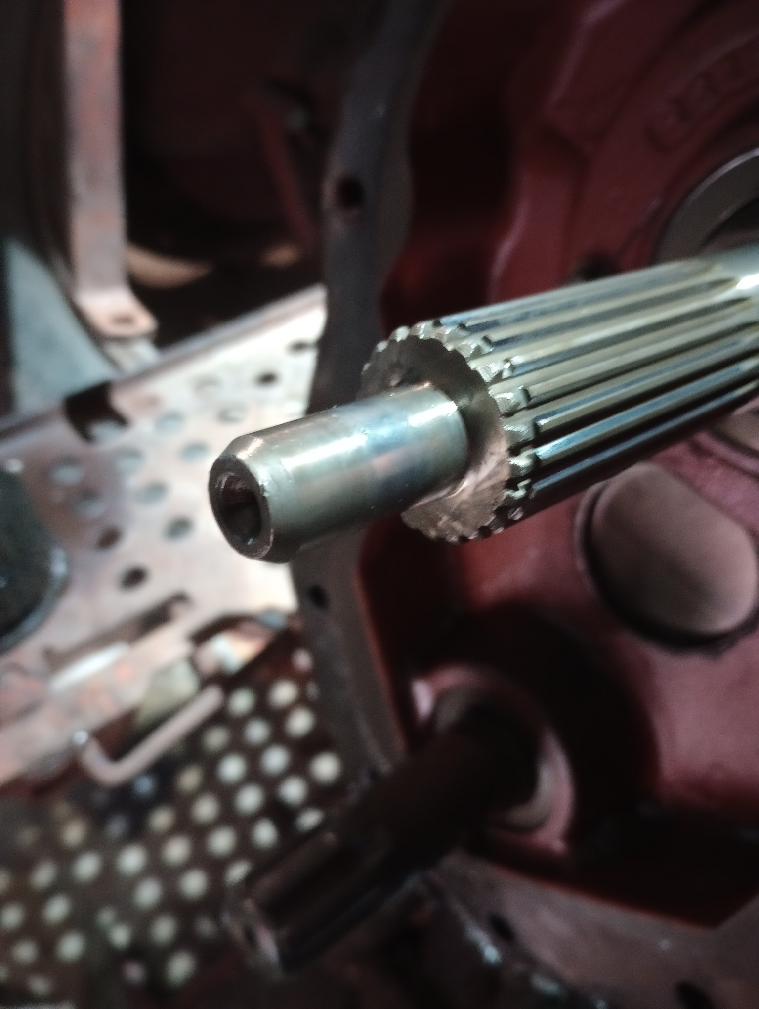

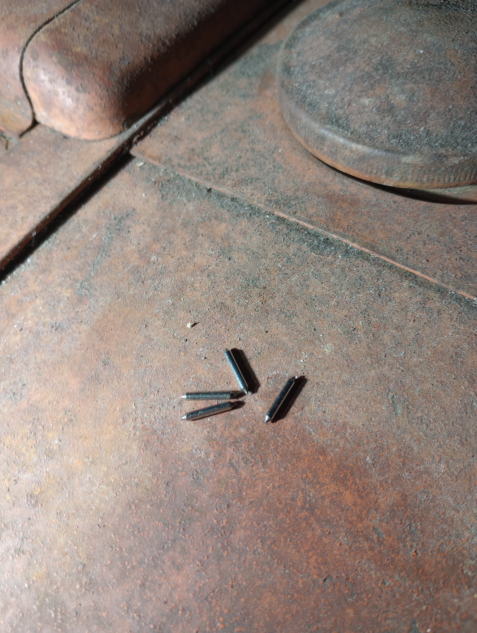

In the process of replacing some worn out parts on the power director. Noticed a bearing was coming apart during the splitting process. Ordering the new bearing and sleeve from Agco. Was looking for advice on the best way to remove the bearing and sleeve. I'm hoping I won't have to remove the whole shaft. Maybe someone else has changed this bearing before? I've included pictures. Thanks for help as always.

Remove all the needles with a magnet. Take a torch and heat the outer race until it turns red in several places. Let it cool down and remove. It doesn't take much time to turn things red and will not hurt the shaft one bit.
