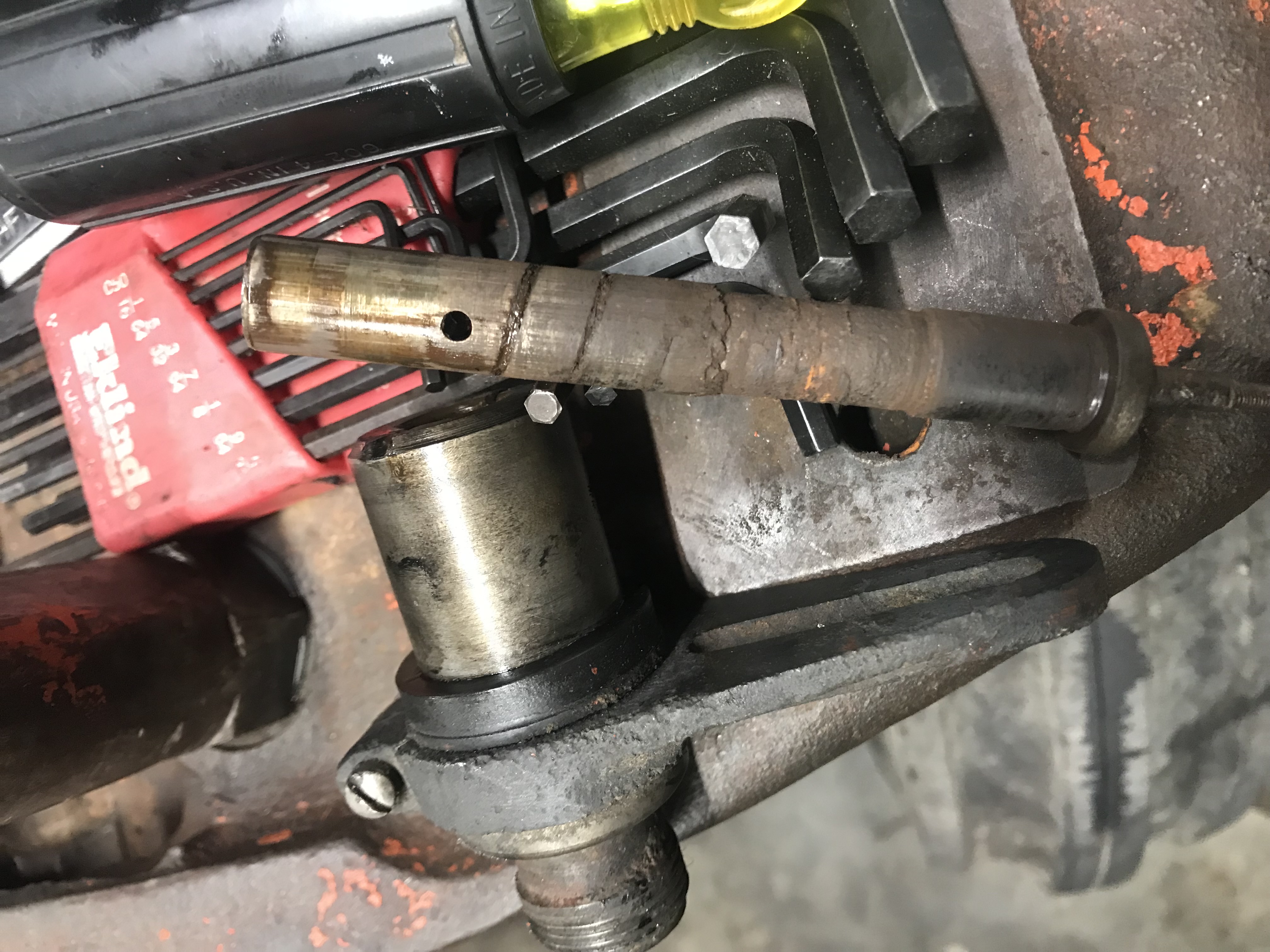

Post Options Post Options   Thanks (0) Thanks(0)   Quote AC720Man Quote  Post ReplyReply Direct Link To This Post Posted: 03 Mar 2023 at 7:44pm
Jason thanks for the phone call and pictures that you texted me. You were exactly correct and I successfully removed the drive and disassembled it in order to get the cable removed from years of rust. Appears to be the original cable. Cleaned and lubricated the drive. Haim at Star Speedometer is making me a new factory correct cable.
Thanks Jason!!

Forgot to take a picture of it cleaned up before I reassembled it.

Points: 5250
Post Options Post Options   Thanks (0) Thanks(0)   Quote AC720Man Quote  Post ReplyReply Direct Link To This Post Posted: 06 Mar 2023 at 8:30am
I’m a huge fan of Kroil but I soaked it several times since I had my Tach rebuilt and it didn’t work. May be the first time Kroil didn’t creep to get it loose. After I disassembled I could see why. I use never seize in most applications but I didn’t use never seize because it is designed to draw engine oil up the tube via the spiral design. Since I cleaned it well it should work as designed.

Points: 5250
Post Options Post Options   Thanks (0) Thanks(0)   Quote AC720Man Quote  Post ReplyReply Direct Link To This Post Posted: 24 Apr 2025 at 10:13pm
Points: 5250
Post Options Post Options   Thanks (0) Thanks(0)   Quote AC720Man Quote  Post ReplyReply Direct Link To This Post Posted: 24 Apr 2025 at 10:16pm
This is mine from 2 years ago, had to remove the entire drive assembly to get it apart. As you can see it was full of grime from 66 years of use.
