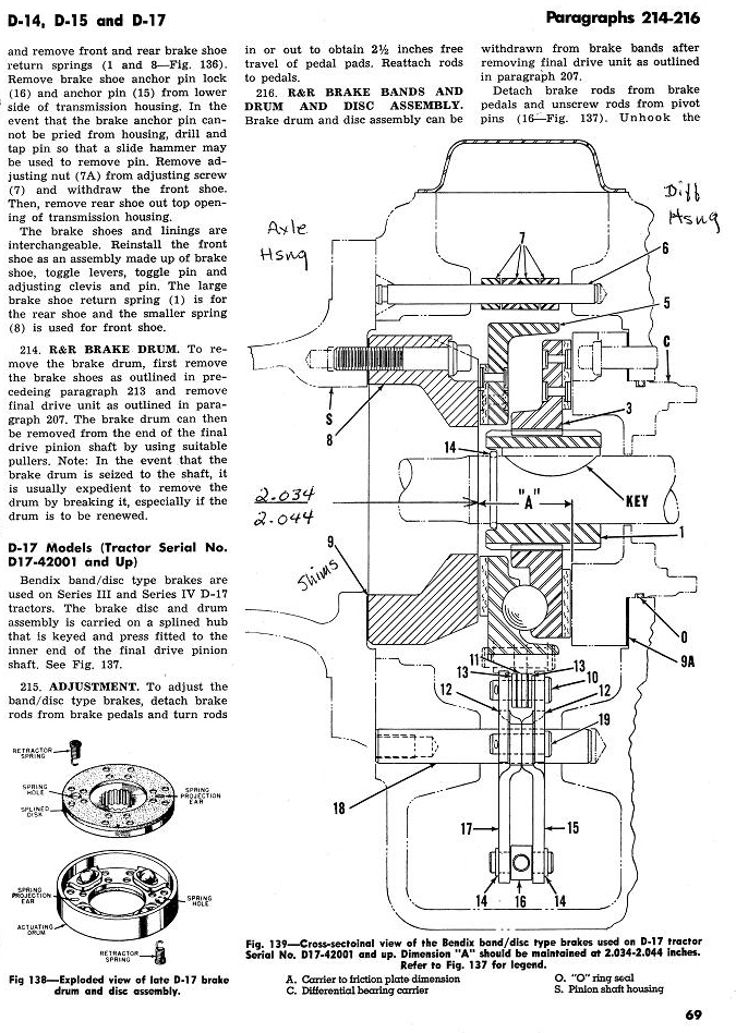

Here's where some people who dis the I&T manual need to read up on how to service the SerIV brakes. The A-C manual doesn't address the issue and how to make certain the gap between the brake disc and the housing is correct.
This is important for performance and will prevent the band/disc brakes from locking up if done properly.
Replace the Retracting Springs, item 2 Fig 137, while things are apart.

Wasn't it a problem finding shims? If you can't find a shim set you'll need to buy some sheets of shim stock and make your own. If the rod is seized at #16 now is the time to remove it. You'll need less blue language if done when it is apart. Taking a shortcut may save time now but will cost you in the future.
