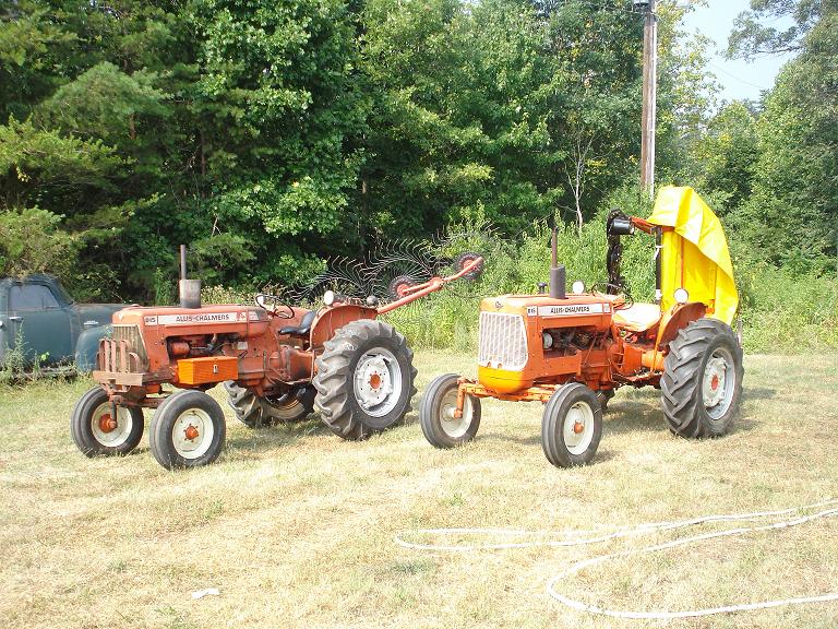

On my 1968 Allis D15II, I am needing to get the Carb rebuild and don't know which kit it is I am in need off.  I am sure the difference in the kits has to do with the age of the tractor, earlier being different that older, so which carb would be on a 1968 D15II? Thanks in advance for any help.
