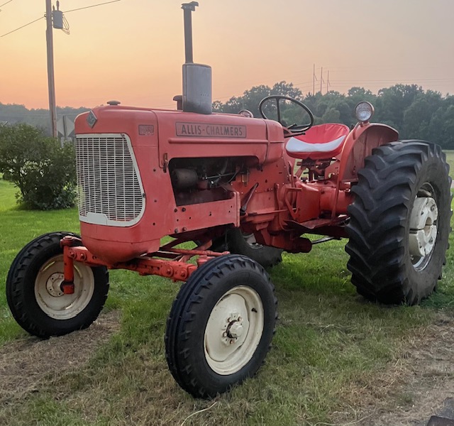

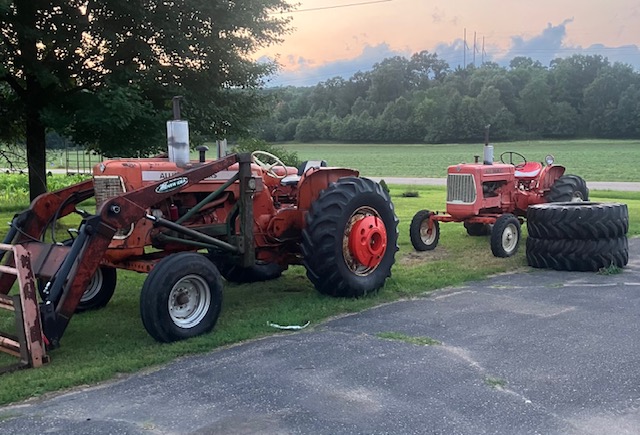

Post Options Post Options   Thanks (0) Thanks(0)   Quote Travis2766 Quote  Post ReplyReply Direct Link To This Post Posted: 01 Aug 2025 at 7:59am
I put new front tires on the D15 last weekend and I had the tire guy out the other day to work on a leaking tube on the D17 and I figured why not have him put the 16.9’s on the D15. 3 tubes, 10 gallons of fluid (D17) and $800 later. I think the old D15 looks pretty good wearing 16.9’s!
Edited by Travis2766 - 01 Aug 2025 at 8:02am

Allis dave View Drop Down
Joined: 10 May 2012
Location: Northern IN
Points: 3073
Post Options Post Options   Thanks (0) Thanks(0)   Quote Allis dave Quote  Post ReplyReply Direct Link To This Post Posted: 01 Aug 2025 at 9:47am
That looks good to me. I always like the slightly bigger tires. They don't bulge out from the rim too much
