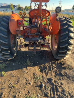

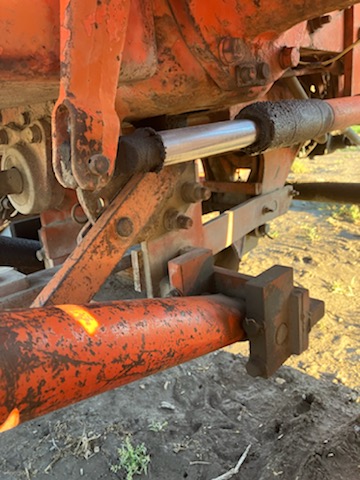

i have a d15 17278 sn at the shop to re pack some loader cylinders and was looking at the factory three point hitch  has any one tryed putting that setup on the d17

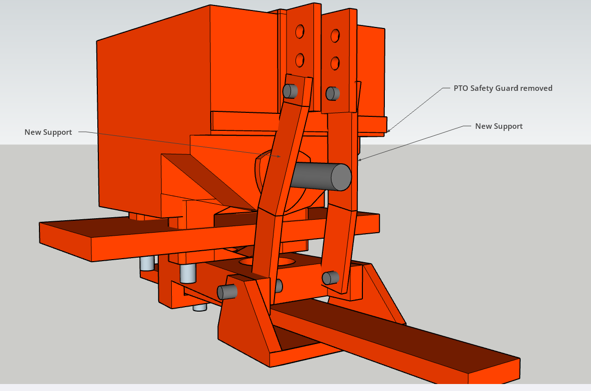

D15 Series II factory TPH Drawbar
Here is an improvement to the Drawbar support we implemented on our D15 II after overloading with the manure spreader, the rear tractor wheel hit a pothole shocking the system and breaking one of the four mounting feet that bolt up into the main frame.  We replaced the broken main support with a new factory part (back in mid 1970's when parts were available) and added the support bars shown below
The improvement worked for many years after - solved our overload problem
Key Notes:
- not to scale, drawn from memory, basic model to show new supports location
- new support bars 1/2" thickness, regular carbon steel
- PTO Guard removed (cut out new support bar opening and reinstall if desired)
- new support bars need to be very tight fit, to carry load - no slack in holes/bolts
- support bar bends required to allow access to PTO
Hope this helps some D15 owners
PS there are several excellent Drawbar Support design solutions available.  This one was very simple, we did it ourselves on the farm, and it worked!!!!
1963 D17D Series III. 1965 D15 Series II. 1965 D17 Series IV. 1975 185. 1978 716H. 1979 716H. 1965 780 Harvester/1R&DC. 1957 Model 73 SC 4 Furrow Plow

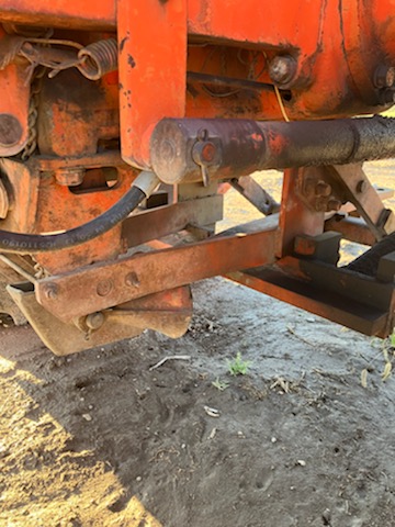

this is what i biult on on my wd about twenty five years ago its had alot of heavy loads on the three point and drawbar

Post Options Post Options   Thanks (0) Thanks(0)   Quote HudCo Quote  Post ReplyReply Direct Link To This Post Posted: 11 Oct 2025 at 3:43pm
cant see the draw bar good,    arms off of a case

Post Options Post Options   Thanks (0) Thanks(0)   Quote Leadoff Quote  Post ReplyReply Direct Link To This Post Posted: 11 Oct 2025 at 4:43pm
HudCo
You developed a very substantial design, and has done the job for a very long time
Congratulation on a low cost, effective solution
