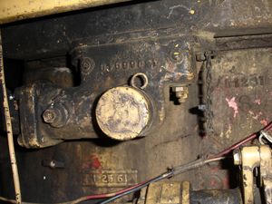

Well it is getting cold and I realize that I do not know anything about starting my D15 in cold weather. Below is a picture of the intake manifold. Do these typically have intake manifold air heaters (and am I missing some critical wiring in the photo? I know nothing about these so if someone can tell me the basics I would appreciate it. I assume there should be wiring that goes back to a switch on the console. I was taught in general that either is bad for diesels and should be avoided if possible, so I assume a manifold heater is an important component. Thanks for the help.

James, the air horn pre-heater looks like a big spark plug.  It takes a small battery cable run to a solenoid, and a switch wire run to the dash.  On my old D-19, the solenoid was there, along with the switch wire, just had them disconnected, cause it had auto ether system.  I just used the auto ether switch, which was on the dash, push and hold button, center of dash.  I think the way the switch was supposed to be wired, was to the left side of the key, twist left and hold to glow.  I think your pre heater is there, left of center of your picture, the thing with a nut on it left of the ether port.  Don't glow if using ether, BOOOOM...
