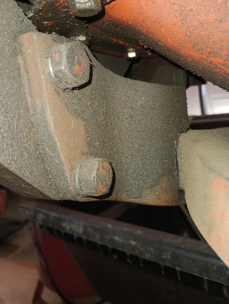

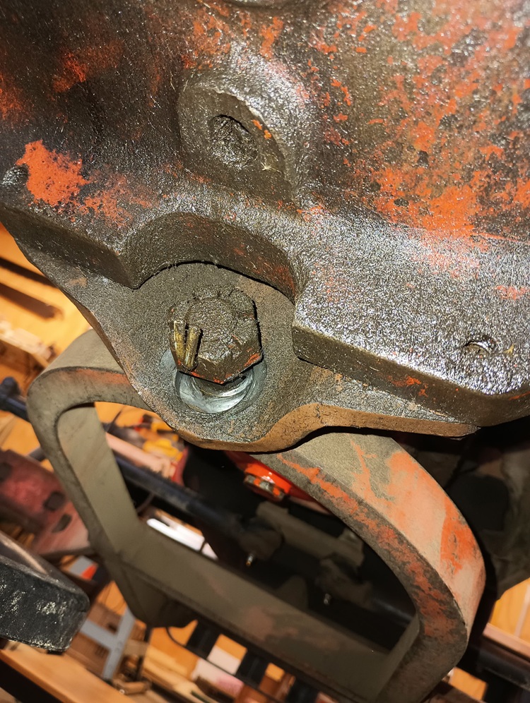

Post Options Post Options   Thanks (0) Thanks(0)   Quote ACinSC Quote  Post ReplyReply Direct Link To This Post Posted: 15 hours 42 minutes ago at 1:33pm
Took a couple pics of this on my Series 1 D 15
Maybe they'll help ? Favorite son should post them soon. Good luck

Post Options Post Options   Thanks (0) Thanks(0)   Quote DAC9 Quote  Post ReplyReply Direct Link To This Post Posted: 13 hours 7 minutes ago at 4:08pm
Thank you for the information and photos! This helps a lot! My next task is to inspect the front pivot pin   area for wear. Was wishful thinking I might just need a simple part at the bell housing. Thanks again!
