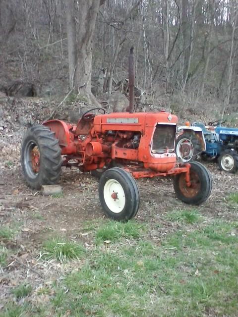

I’m adding the second battery (fender mount) to my D15 Diesel Series 1. What size cables do I need to run? I can’t find any information as far as OE goes so I’m thinking 1/0 just based on length and amperage. Does anyone have any firsthand knowledge they can share?
