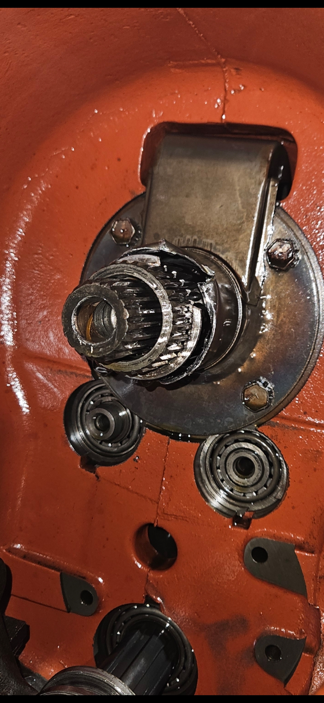

I also decided to take a look at the power director since I had it apart. It was a little noisy but was still working. For some reason the tin shield got all chewed up. I really dont know how this happened. The bearings seem tight. The snap rings were all where they needed to be. The drive hubs should not have been able to make contact here, but something happened.

Post Options Post Options   Thanks (0) Thanks(0)   Quote Tracy Martin TN Quote  Post ReplyReply Direct Link To This Post Posted: 8 hours 4 minutes ago at 9:02pm
Looks like a shade tree mechanic tried to remove snap ring. Does look like a failure internally. If so, there will be parts in bottom of sump housing. JMHO, Tracy
