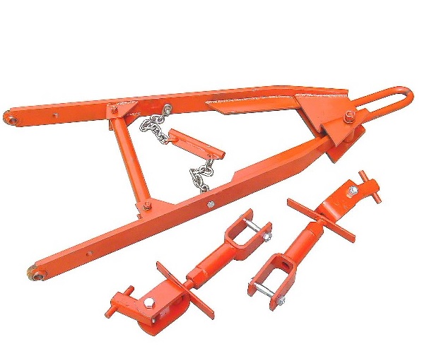

There is a bit of a wishbone look to the bottom braces / arms, which attach to a plate. I do not see any remnants of a snap couple system
Where/ How do the lower 3 point arms attach to the tractor under the transmission ?  The Factory or any aftermarket hitch that uses the snap coupler would be similar to this..

Steve - this is the unit I have, minus that cross stabilizer bar, which is missing. (I will be on the lookout for a replacement.) So I do have the snap coupler? And it sounds like this is a good set-up, correct? Just make sure that all the hardware is tightened up? Thanks for including the diagram!

Points: 55283
Post Options Post Options   Thanks (0) Thanks(0)   Quote DiyDave Quote  Post ReplyReply Direct Link To This Post Posted: 02 Dec 2021 at 5:46pm
If you have that unit, you have a snap-coupler.Thumbs Up
