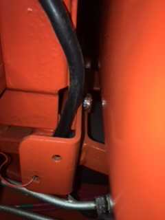

So i got my new parts yesterday.  Put new points (and gapped to .20), condensor, distributor cap, dust cap, and a new internal resisted coil.  Still will not start.  It has spark at the points and spark going to the plugs checked by tester (pictured below). Plugs get wet, so it is getting gas. While working I dropped my work light, and, in the dark found out what was causing the smoke mentioned in earlier posts.  Earlier, I thought it was the battery smoking but it is not.  When the light was off, I noticed a bolt that connects the gas tank support bracket to the side of the battery box glowing orange when I had the starter engaged.  When I let the key off (starter not moving) no glow.  Turned key to engage starter, bolt was glowing again.  Being so close to the gas tank is a little scary. Hopefully the picture I took will show what I am talking about.  The black wire shown is running from the battery to the starter (positive)  In the picture it looks like it is touching the bolt that glows but it is not, it is a few inches away. The silver line on the bottom is the gas line.   Orange metal on left of picture is the battery box.  Orange metal on right of picture is the gas tank.  The flat stock is the gas tank and battery support.
Does it sound like a bad ground (causing the bolt to glow orange)?
Could the voltage regulator be bad?
**How do I start the tractor bypassing all wires, gauges, switches, and other crap?  In other words,  I want to start (and be able to shut off) tractor with just battery, starter, coil, and distributor.  I figure if I can at least get it started without any extra stuff, I can then go back and trace wires and hopefully figure out what is wrong.

Could the glowing bolt just be a sign of a bad ground? The wire is new from - side of battery to metal on top of the battery box. The battery box sit on the tractor and Gas tank support is attached to battery box at the bottom by two bolts. One of those bolts is the one heating up.

Nothing should be heating up anywhere.  Take the bolt out and use a wire brush all around near where the hole is. The terminal on the cable may be oxidized to the point where you'll need to brush it down to the copper. I'd replace the bolt. You want bright shiny metal at all your connections, before you put the wire on them. Use a drill motor and round wire brush. Once a connection oxidizes it's very difficult to clean.  This may be your problem. There would be a large voltage drop at this point.

There's a NICE bolt hole on the left side of the block that I use for GROUND for the battery.Yes...not 'correct' but I've never had hot bolts ! Having all that currnet running through a bad connection will drop the voltage down to 'not enough' to give real sparks in the engine.
I'd replace and rewire the ground wire.

I think that is where I need to start. Cleaning that area and new bolt. Although it is clean. I replaced all wires when refurb. Bat terminals are shiny clean. No crud anywhere as I just restored a little more than a year ago. What a pain because to get to the bolt and clean it good, I’ll have to take hood and gas tank off.
