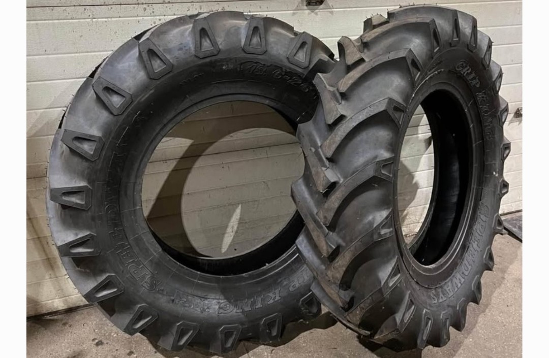

Tires I am looking at, are Brand new with the tits on the tire. Made in 2013, but never mounted on a tractor and always stored indoors.
Any risk on a tire like that from 2013? From the pictures I seen they do look brand new.

Post Options Post Options   Thanks (0) Thanks(0)   Quote DrAllis Quote  Post ReplyReply Direct Link To This Post Posted: 28 Jan 2025 at 6:26pm
I sure wouldn't worry unless they are a very cheap overseas brand. How do you use your D-14?? How many hrs per year???

Dr. These are 8 ply Grip King tires...looking at them tomorrow got it lined up.

Post Options Post Options   Thanks (0) Thanks(0)   Quote DiyDave Quote  Post ReplyReply Direct Link To This Post Posted: 28 Jan 2025 at 8:57pm
Actually if they were stored inside, with no sun, it makes the rubber in the tire a little harder and abraision resistant. Made in India, if I read my googles right...Wink

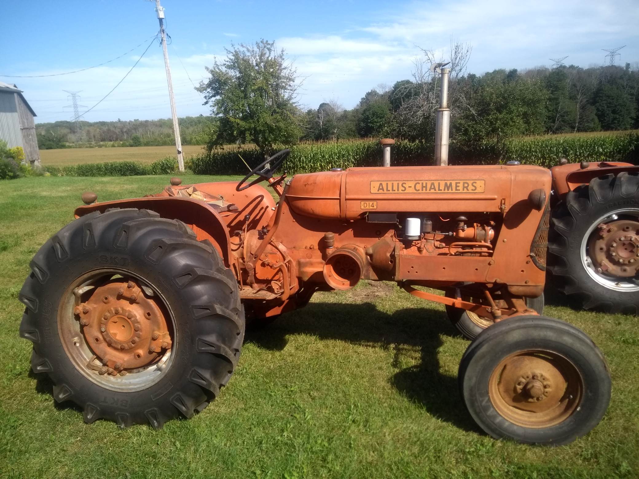

I have upsized to 14.9 x 26 on all 3 of my D14s.  No need to change rims.  I have had good luck with BKT TR-135 tires.

Post Options Post Options   Thanks (0) Thanks(0)   Quote Don(MI) Quote  Post ReplyReply Direct Link To This Post Posted: 29 Jan 2025 at 4:36pm
Excellent condition, brand new and still plyable Rubber to th3 touch... picked them both up for $500

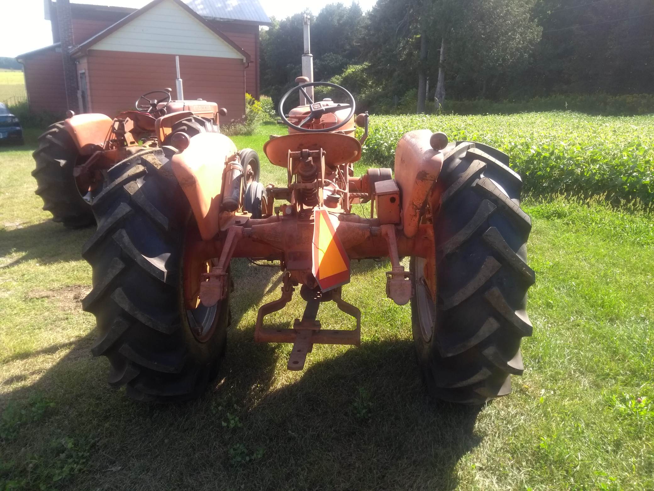

I’m a fan of BKT tires, have them on my 190XT. How does the 14.9 look on a D14? Are they as tall as the fenders? Can you post pictures of one of your tractors Myron? If a 14.9 fits the stock rim I don’t have a problem upsizing, far more choices.

I have 2 D14s with the BKTs and one on Firestone Field and Road.  Here are the BKTs
Points: 5250
Post Options Post Options   Thanks (0) Thanks(0)   Quote AC720Man Quote  Post ReplyReply Direct Link To This Post Posted: 30 Jan 2025 at 3:24pm
Perfect picture and I like them! You have a 1959 3 bar black grill like I just purchased. You just made my decision easy, thank you for the picture. Mine also has the belt pulley and I’m in the process of adding power steering. Nice looking tractor.
DSeries4 View Drop Down
Location: Ontario, Canada
Points: 7539
Post Options Post Options   Thanks (0) Thanks(0)   Quote DSeries4 Quote  Post ReplyReply Direct Link To This Post Posted: 30 Jan 2025 at 4:09pm
The one pictured is actually a 1960, but I also have a 59.  Both have black bar grille, factory power steering and belt pulley.

Post Options Post Options   Thanks (0) Thanks(0)   Quote Gary Quote  Post ReplyReply Direct Link To This Post Posted: 30 Jan 2025 at 7:46pm
Rob
Note that Myron has shifted the Power Shift Rear Wheels Outboard until the Wheel Eccentric is located between the first and second holes for the Wheel Stops.
I did the same for my D-15 II with those same tires.
Gary
Points: 5250
Post Options Post Options   Thanks (0) Thanks(0)   Quote AC720Man Quote  Post ReplyReply Direct Link To This Post Posted: 30 Jan 2025 at 10:10pm
The wider stance looks better anyway, mine are all the the way in which I do not like. My eccentrics are frozen so that’s the only reason they are still spun in. Another issue I need the care of when I replace the pinion and axle seals, tires and brakes.
